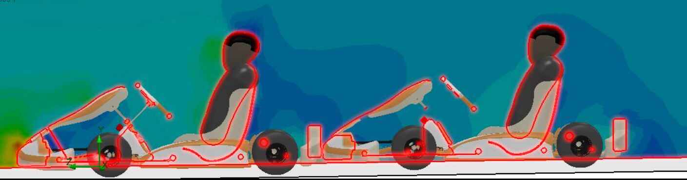

@Matt_Geist did a bunch of flow analysis about 5 years ago. Maybe he or @KartingIsLife can dig them up.
I obviously cant remember the numbers but the difference was big enough that he showed up to Battle at the Brickyard with a metal bumper on his Tony Kart, which was pretty rare at the time.
Maybe the difdeeence is that the plastic bumpers, being solid, create a small zone of still air behind them when tucked into the other guys rear bumper. The metal ones allow air to pass through as they aren’t solid. You’d think it would be a tiny effect though.
