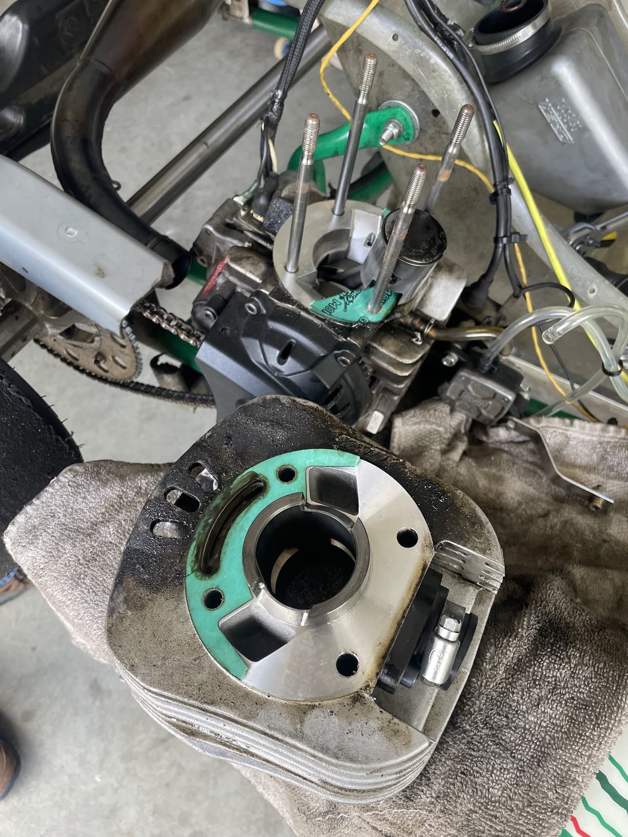

Last weekend I pulled the block to check the base gasket and found a lot of areas that it was compromised.
The first time we ran this engine after it sat, I made the mistake of putting washers in between the exhaust and the cylinder. This created exhaust leak and my latest hunch is that the heat/dissipation of the exhaust/loss of compression compromised the base gasket.

It does not look comprimised to me, except that it broke When you tolk off the cylinder.

Thanks @Bai7200 . Yes, I’m aware that it split when I took the cylinder off. What I’m referring to is the seepage from the back of the cylinder/exhaust area that resulted in all of the fuel/oil residue.
I measured the old gasket and bought a few in that size, as well as a few of a different size in case I needed to adjust squish.

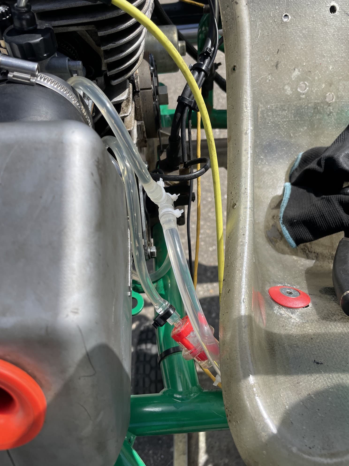

A fuel return with a y splitter may help as well. It will take the pressure off of the needle making it easier for it to function.

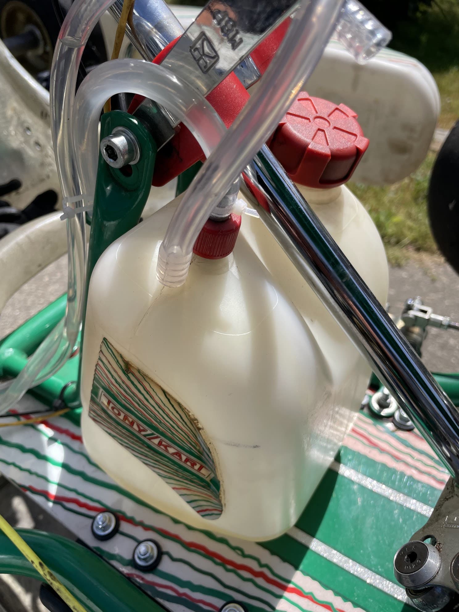

We had this setup when the engine was on another chassis. But with this new chassis we opted against it since the tank didn’t have another line to route to.
Right now the fuel tank has the main line out and the other line goes to a catch can. If we reinstall the y-line, do we need to tap another line to the tank? Or where would we run it?

We ran a y-splitter when this motor was on another kart. That kart’s fuel tank had 3 fittings - one for the fuel line, one for the catch can, and one for the return. When we mounted this motor on the new Tony chassis, the tank only had fittings for the fuel line and the catch line. So we opted to run without the y-connector & fuel return line. My latest hunch is that the lack of the return line is leaving it fuel-starved at high-throttle.
I just tried to jerry rig it by using the catch fitting on the tank for the return line from the y-connector. This bypassed the catch line. The kart started up easier than it has recently and ran really well on the stand. Only issue was that the catch line fitting is designed more as a breather and doesn’t have metal barbs, so it was leaking fuel. I wanted to test and see if this fuel return line fixed the issue before tapping another fitting onto the tank.
This brings me to my next question for all those who have ran Mini Rok recently - Does the new Tillotson carb require a fuel return line? If so, are they all tapping another line into the fuel tank? If it doesn’t, I’d rather buy the new carburetor (which I’ll need to race anyway) and save tapping another fitting into the tank.
Had the same issue on my son’s cadet. I added the third line into the tank with a barbed pipe fitting. I recall with the right size drill the fitting self taps fairly easy into either the top of the tank or the fuel cap.
