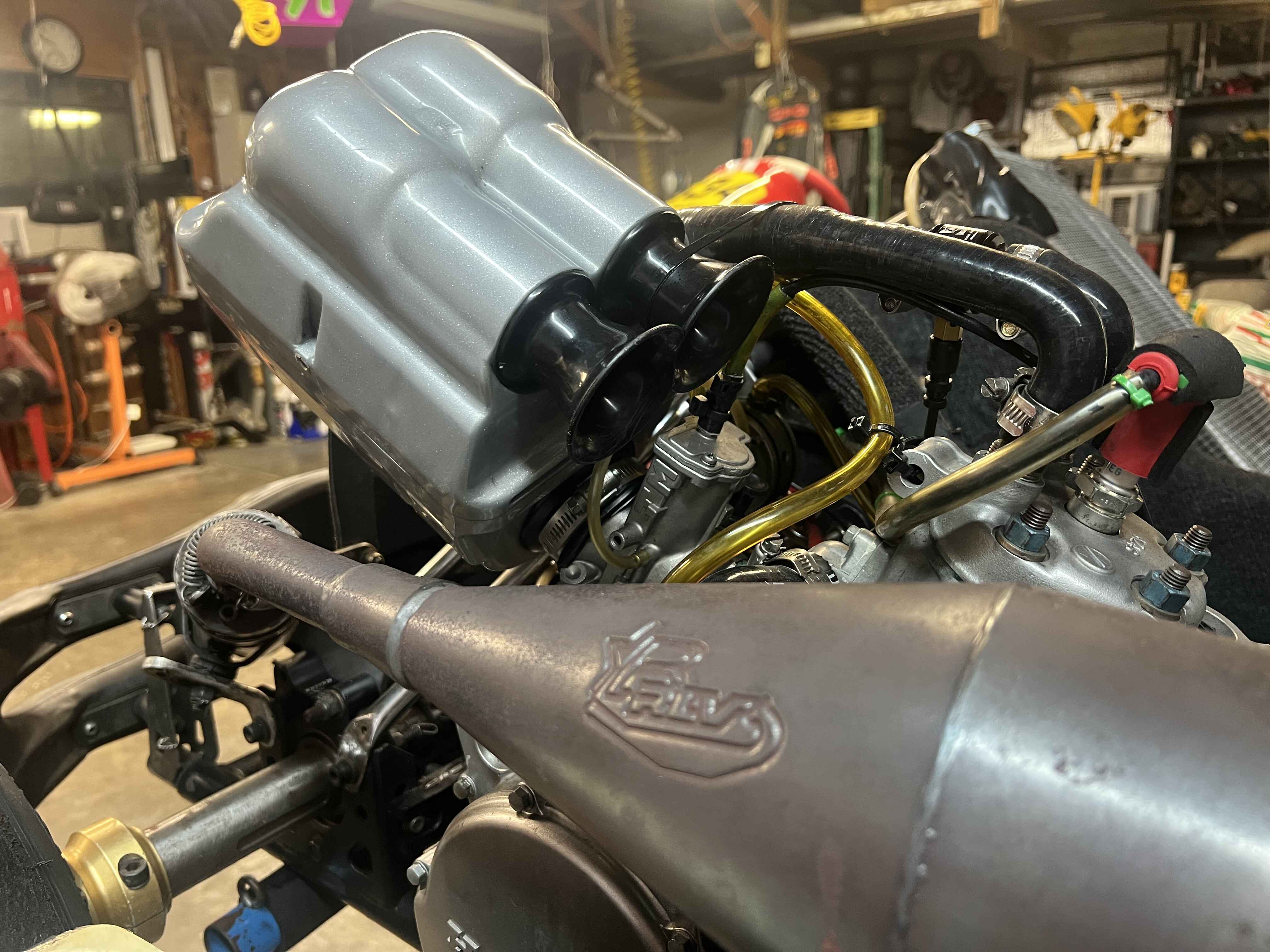

Modern airbox on the old mod honda

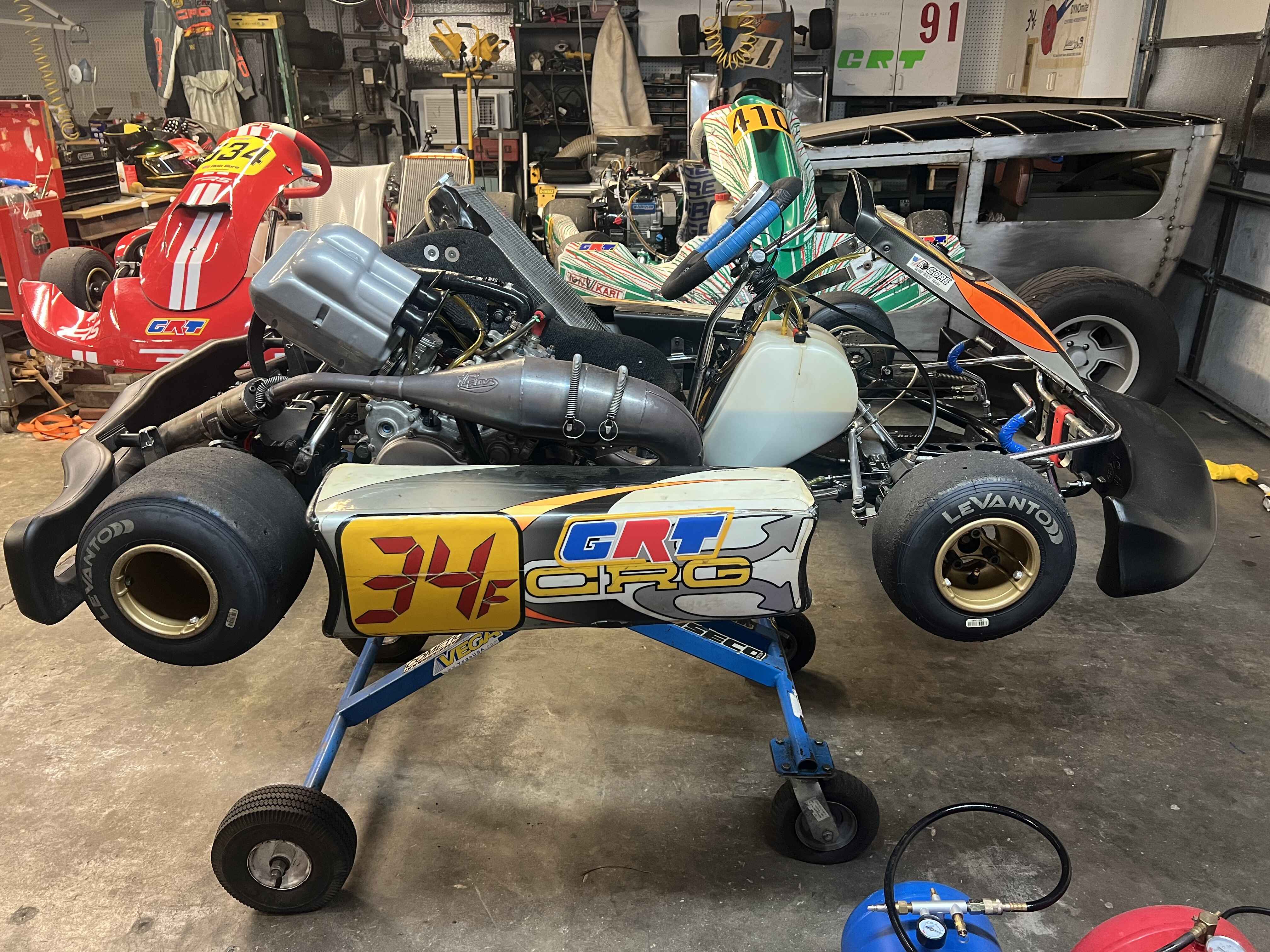

Been thinking about racing my old 2002 mod honda kart in the club series at Jax. I always ran a K&N air filter on it, but the rules there require an airbox. I put a KG Nitro on it, I am curious how the engine will respond. I know from some experiments in the past that the result of a change like this aren’t always inuitive. Thoughts?

My boot for this box is symmetric, but I did see that there is an angled one available which I will probably get. If the box works ok I will probably get one just to get the box in a flatter position with the openings aimed more forward.
