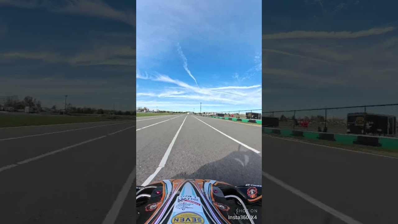

Motori Seven KZ80 is here!
We FINALLY got our shipment of KZ80 engine packages.
Straight from Motori Seven, we’ve got the L8 engine packages here and turning laps!
