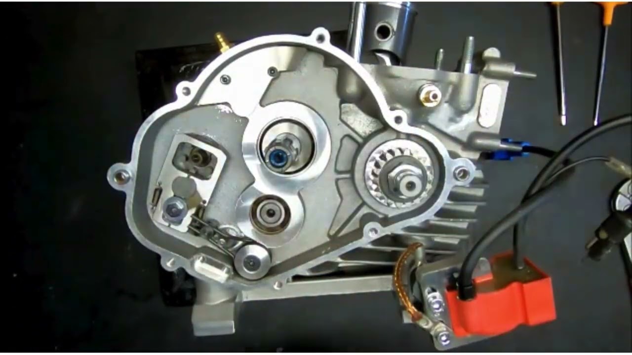

A customer engine ready for his first rebuild - 5 pistons in 80 hrs :shushing_face:
Nice! So no bottom end service at all before 80 hours? That’s awesome!
Yep, only 5 pistons .We’ll share more pictures while rebuilding the engine
KZ80 Junior Basic Engine Reassembly
I’m sorry… did you say 80 HOURS with no bottom end service??
