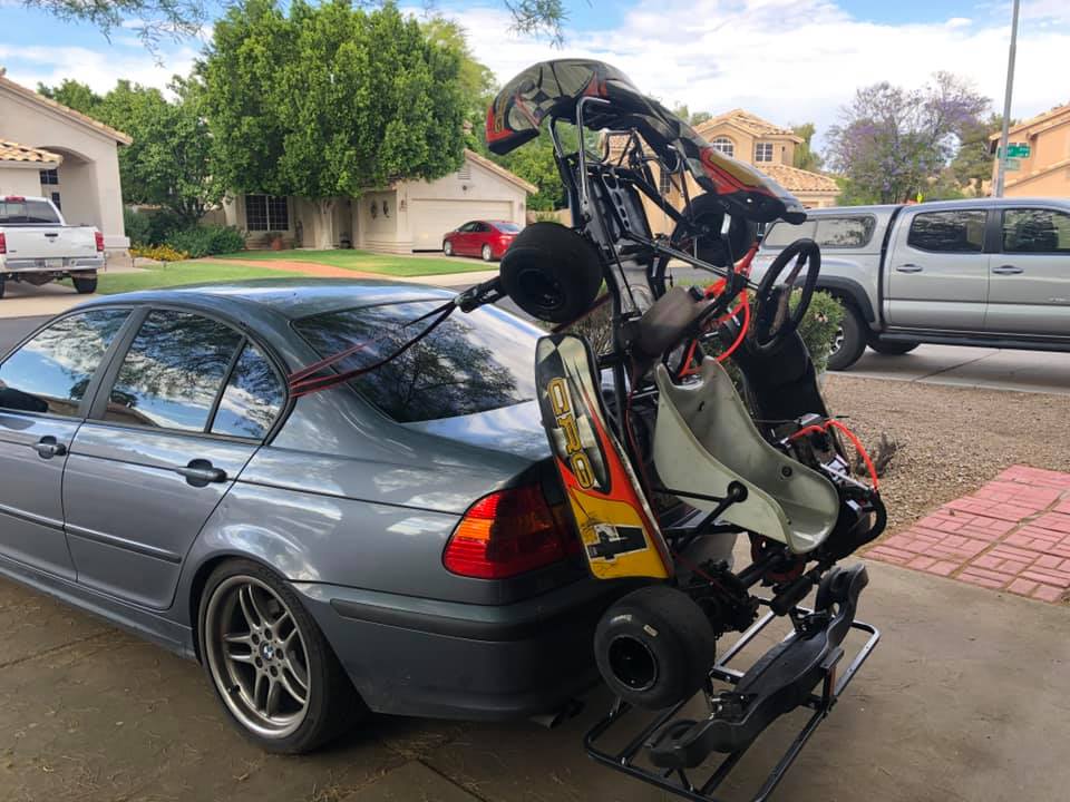

One other important area I had to work through was transport. I considered a few options, including using a local kart shop to store and transport, buying a vehicle specifically for transport, and a trailer. I ended up with a very unconventional method of using a cargo carrier and trailer hitch on the car I already owned, a 2002 BMW 325i. The kart sits on the cargo carrier vertically and gets tied down with ratchet straps. Fortunately for me, I live in AZ where the weather is pretty great, and I’m only 10 minutes from my track. If I had to drive further, I’d probably use a small trailer. My method also has the drawback of the kart covering my license plate and third brake light.
Transport:
Hitch (Amazon) $150
Cargo Carrier (Amazon) $80
Ratchet straps (Home Depot) $20
Trunk support (homemade) free
TOTAL: $250
