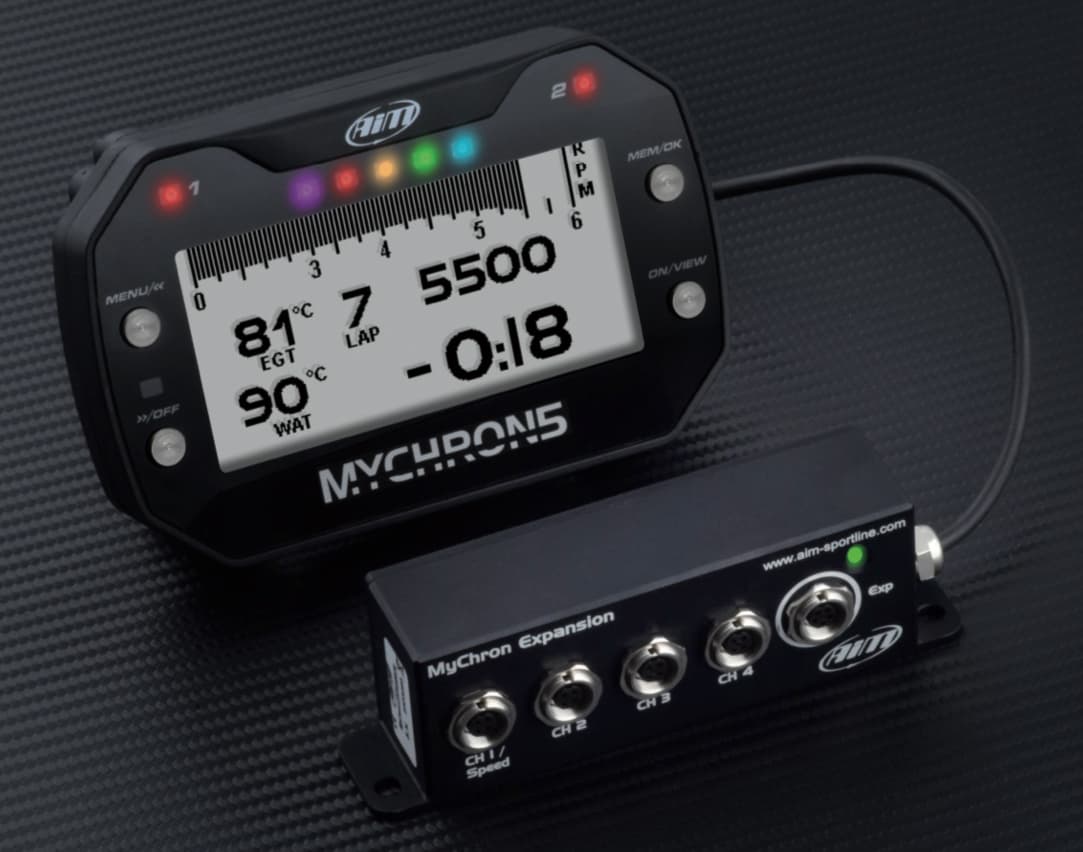

Has anyone gotten external sensors to work with Mychron 6 via the Mychron Expansion strip? I’m at a loss. I plugged an AIM throttle/brake position sensor and an AIM brake pressure sensor into one, plugged that into a 12V battery, and connected to the Mychron 6, but I can’t find any way to configure the sensors (on the screen or in RS3) and the Mychron 6 doesn’t seem to recognize it. The Mychron is charging itself thru the strip, but the strip’s LED isn’t lit. Any ideas?
Is the firmware in the M6 up to date? The expansion was not in the original fw. I will share the menu options in a bit when I’m at a gauge.
Yes, I forgot to mention the firmware is the most recent version (02.44.09), as is the RS3 software. Any help is appreciated. Weird that Aim removed the Expansion setup (for external sensors) from the Mychron. Seems like they REALLY don’t want users running their external sensors.

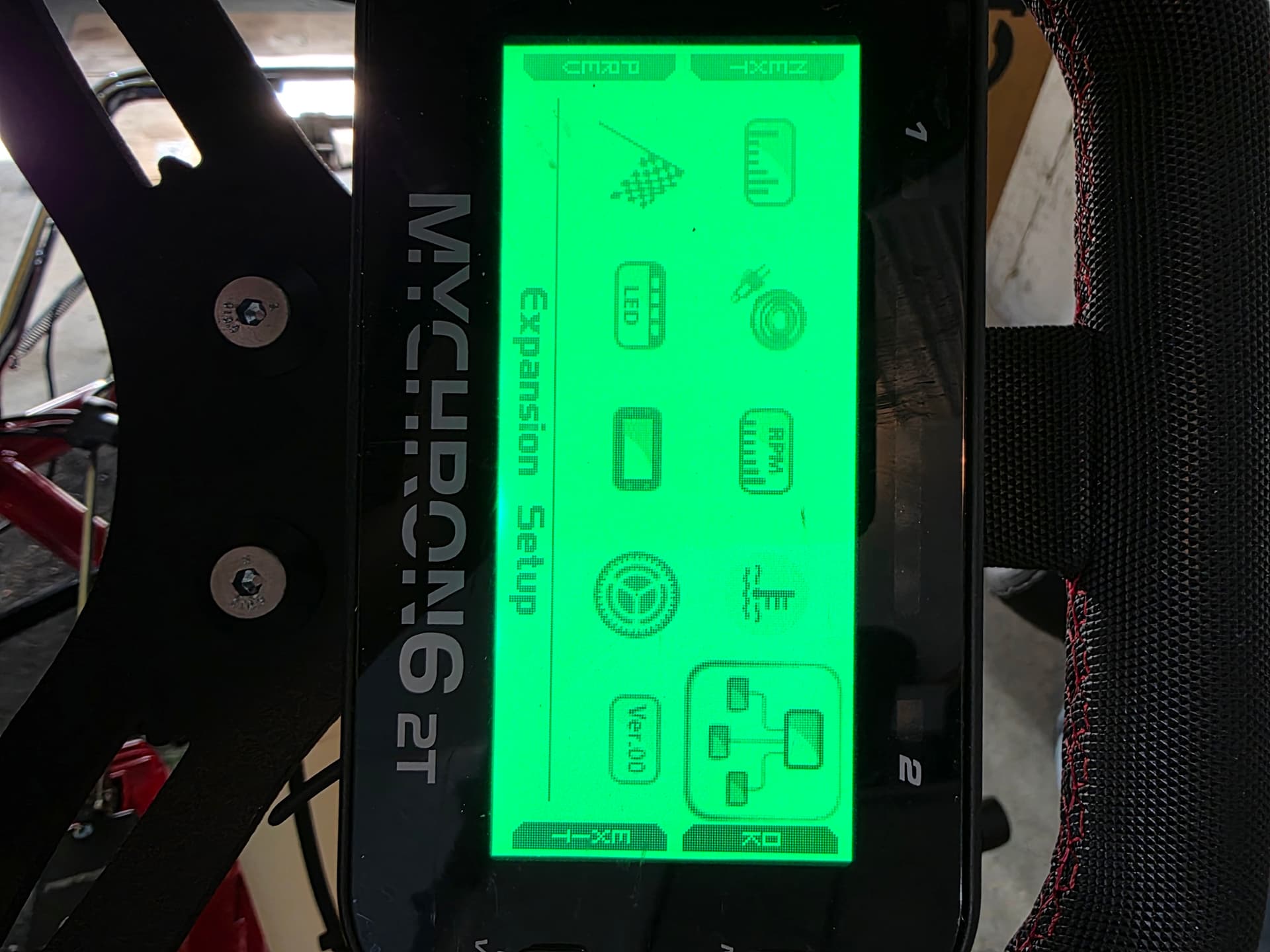

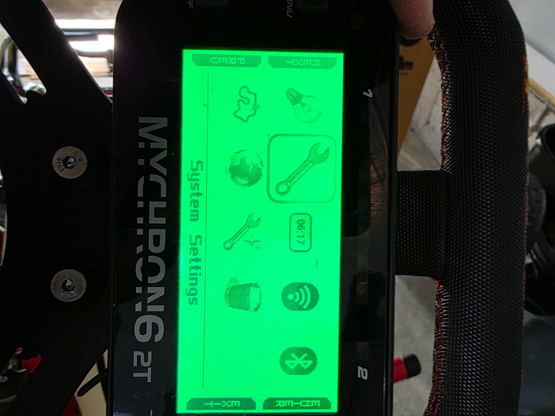

Here are the menu options. First into the menu, then into the wrench for system setup.
Scroll over to the expansion settings.

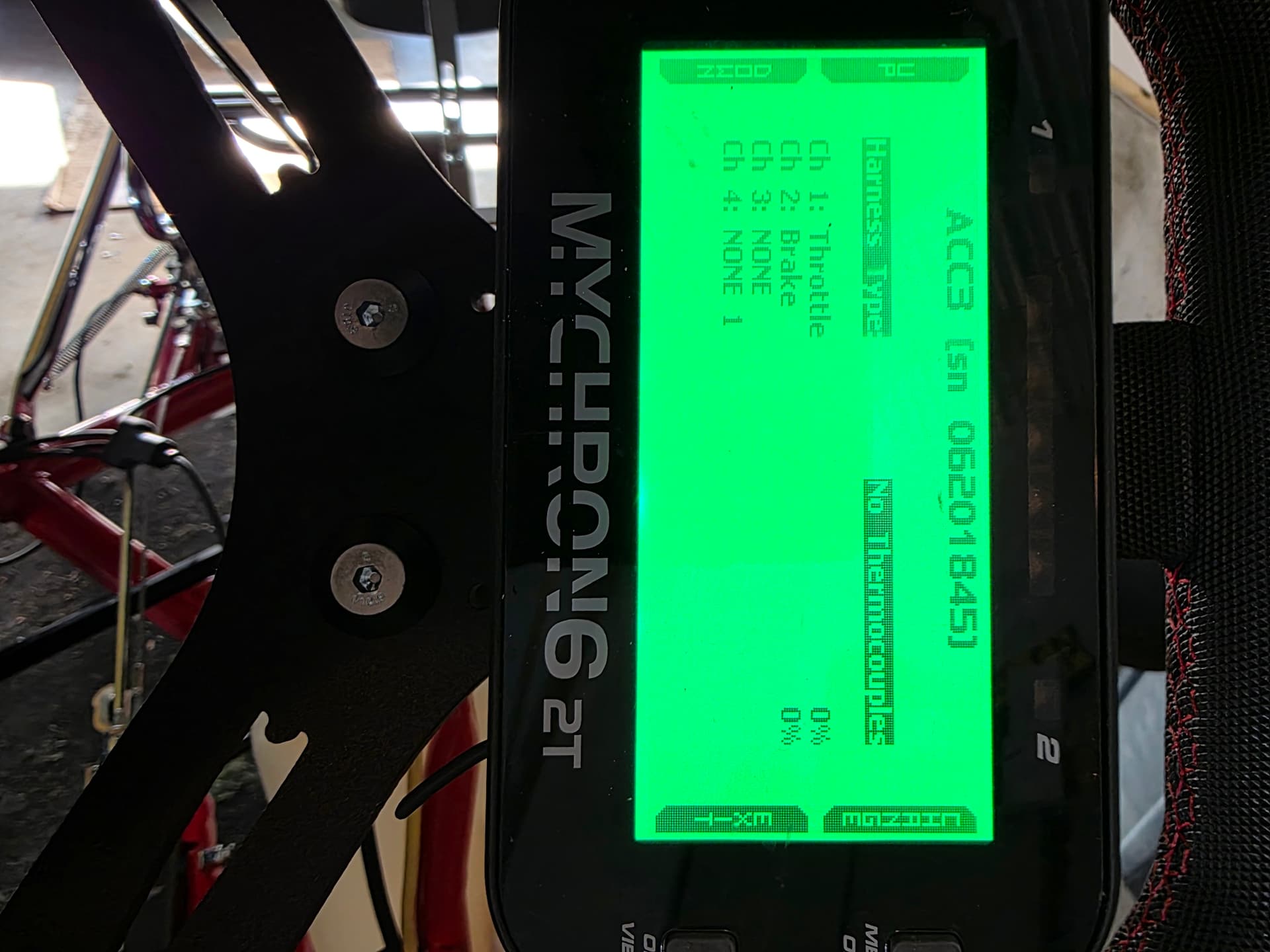

Then you can set what is on each channel and calibrate it if necessary.
If you don’t have the setup screen for the expansion, then it’s not being recognized. Providing the FW is up to date (remember to transmit to the device, not just download), then it would not have power or have an issue.
Thanks Matt! I didn’t realize the Expansion settings only appears when an Expansion device is attached. Which means my Expansion strip must be just dead, despite it providing power to the Mychron. I’ll email you offline about getting the ACC3 bits & pieces.
