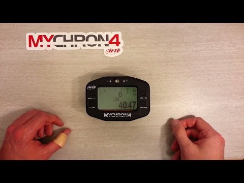

Sorry if this is too basic, but are you asking how to see them on the mychron screen? If so, this button is the one you hit:
Then, you use the left buttons to scroll through. If they arent there, are you sure the beacon on the track is working? Is it turned on too? Is your receiver facing it? Again, sorry for the basic questions, but want to rule out the easy stuff first.
