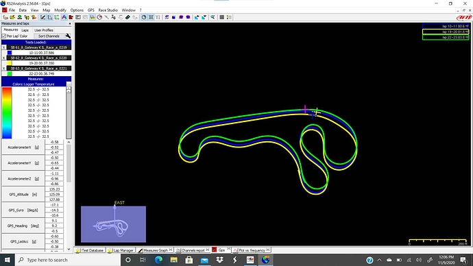

Has anyone had this issue with their Mychron5? My laps are not plotting accurately so they don’t. line up for analysis.

Within RSA, check the values for GPS_Nsat (number of satellites) and GPS_PosAccracy. PosAccuracy should be around 0.6 and 0.7.

Gps is intentionally made a little inaccurate for national safety. It will change somewhat over the course of the day. Within a run, gps will be 100% accurate from one moment to the next. But when you overlay one run with another you’ll see they are different, it equally different over the entire lap. So use this as a tool to evaluate the shapes of your corners. Whether you late apex, diamond the corner or whatever.
Exactly this. I try to emphasize not to overlay the GPS traces to compared driving lines, but to look at the shapes of the lines to determine how two drivers are driving the corner differently.
I haven’t tried this myself to fix this particular issue, but when runs don’t align in the measures graphs you can use the ‘lap insert’ function.
Gps lap insert is buried in the lap manager, tell it to align the run to a previous test - hopefully it aligns the GPS lines too.
The other thing I use it for is to see where my daughter uses the brakes and throttle in relation to a corner. I look to see if she’s trailing onto or off of the brakes and if she’s on the throttle later than she should. I rarely export it and overlay it on Google Maps, but keep it in Race Studio.
I had the same issue. If you look closely at your GPS plot in racestudio you will see your laps (yellow and green lines) overlap. This means you are essentially driving more than 100% of the track and therefore your laptimes will be slower than actual. In my case I also had laps that were incomplete (the GPS plot did not complete the loop) so laptimes were fastest than actual. Check all your data. I had this issue across around 30% of all laps regardless of track. I sent the mychron to aim for a GPS module replacement however this did not fix the problem. They have now replaced the whole unit so time will tell…
