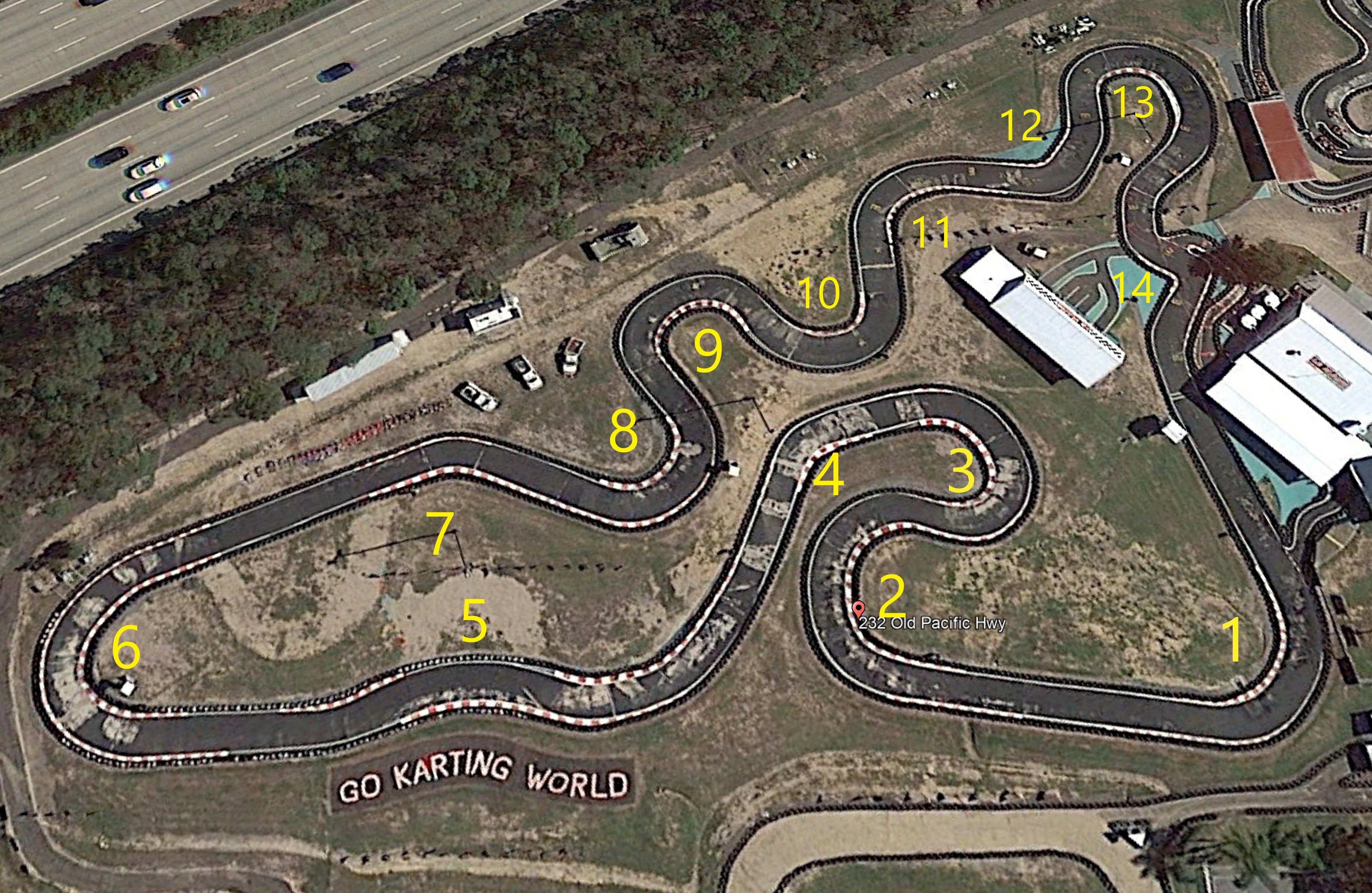

A thought; coming out of 6 through 7 into 8-10. 10-13 looks like an opportunity to gain on folks that overcook this sector into 8.

The map you have there is the old layout, here is the current map:
There were 4 corners that clicked in race 2 that were the main reason of the quicker times. T2 there is a join in the concrete that upsets the kart, I was lifting as a reaction to it. I started lifting just before it and then as soon as I felt the bump I would get back onto the power. T7 was the same with a join and back on the power early, I also started taking a wider approach coming into it.
The other two turns were T11 & T12 which helped me set up T13 which is super important for the main straight.
