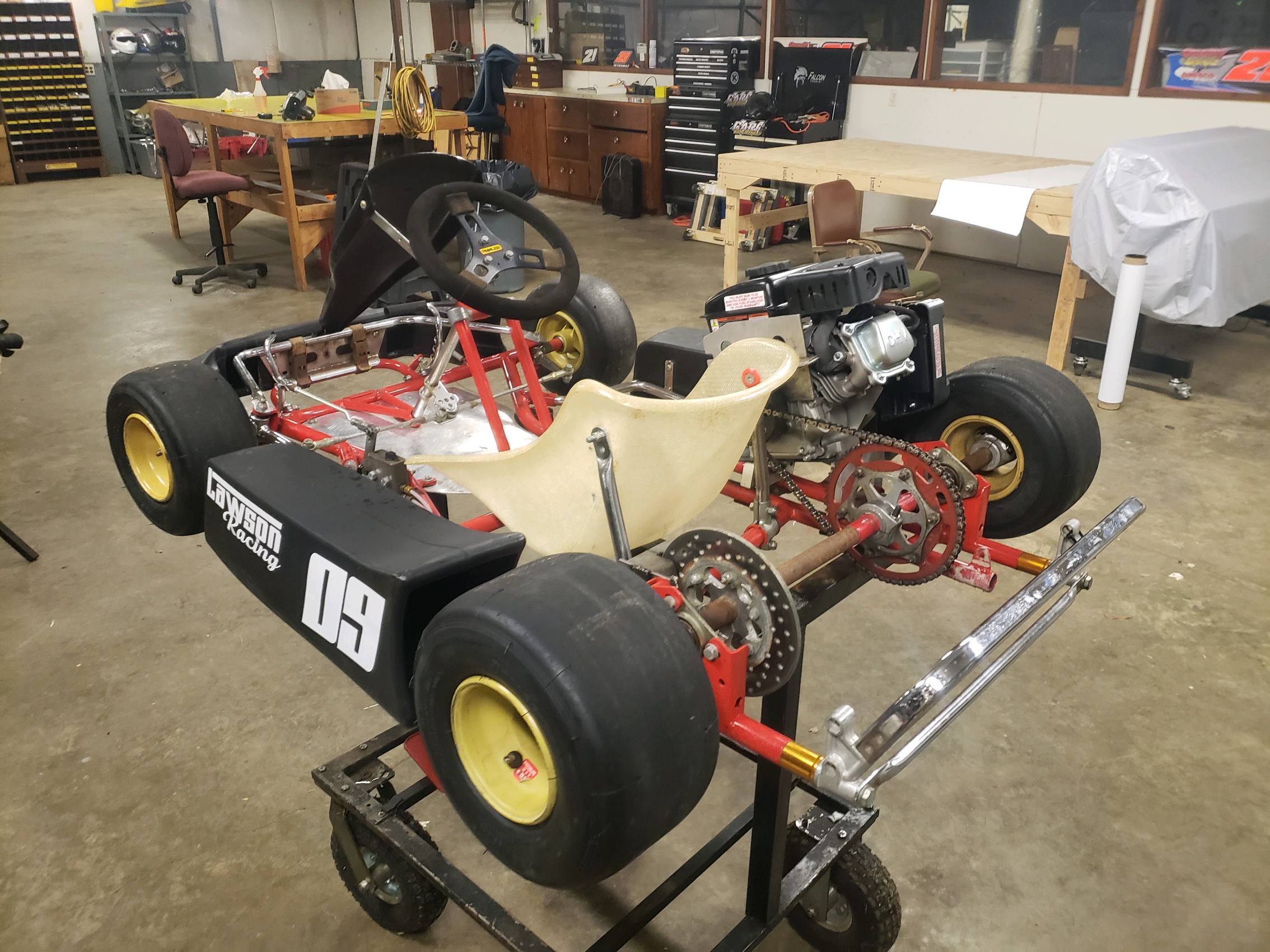

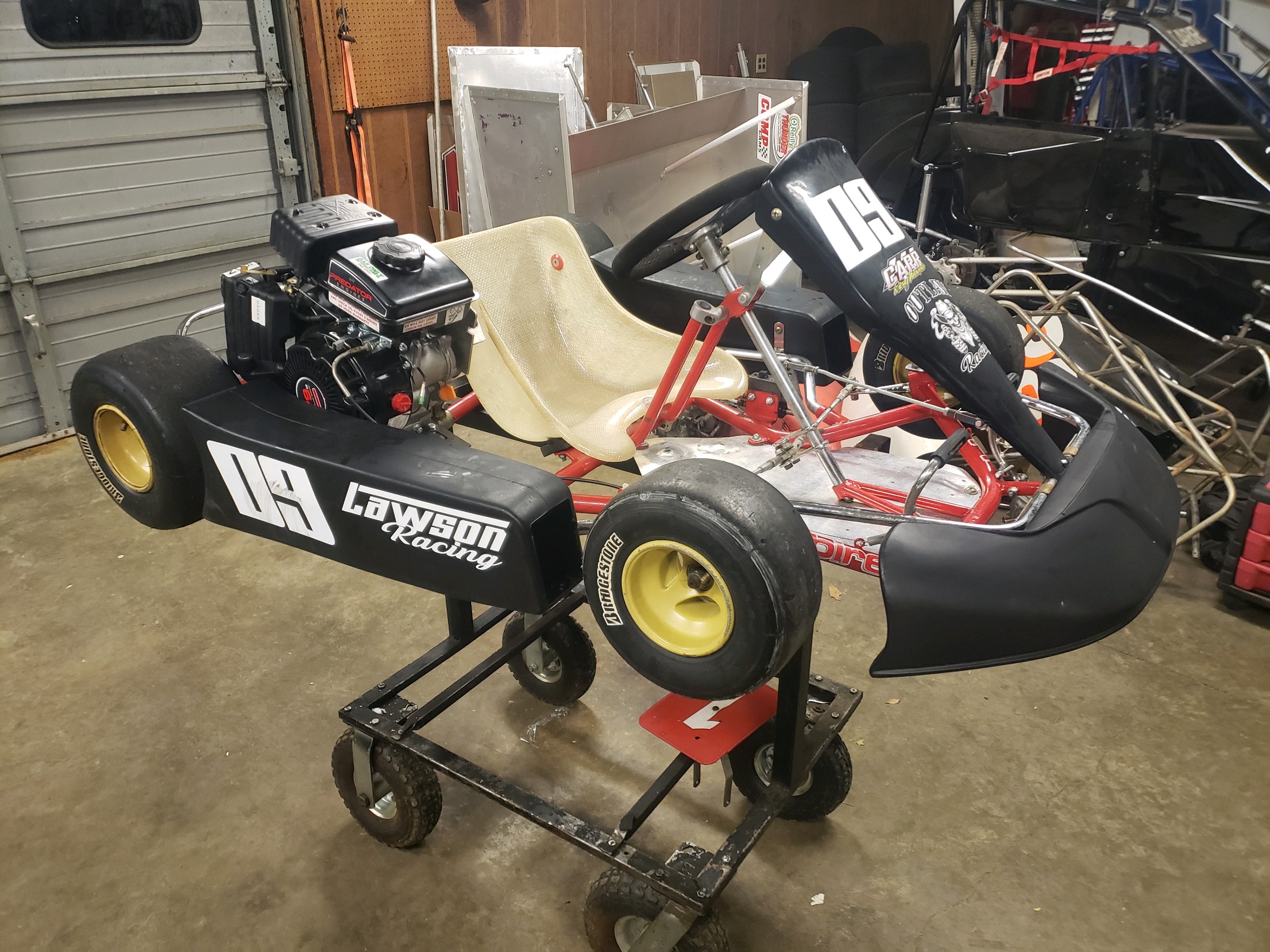

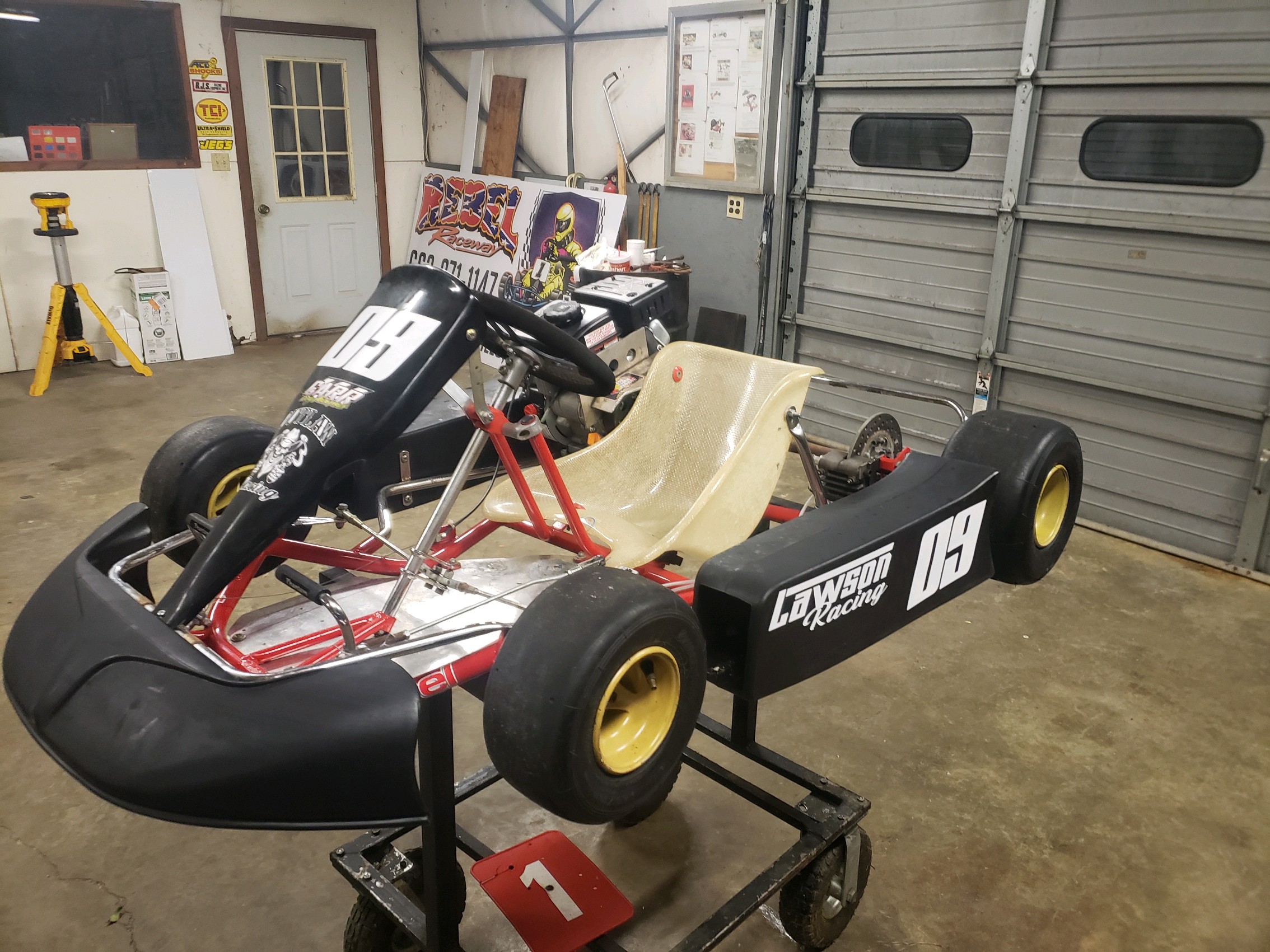

Here is the second kart. This one looks a bit smaller to me. I’ll see both in person tomorrow and have my kiddo take them for a spin!
Yes, that one looks like a kid kart.
Looks more like a kid kart but still looks like it has staggered wheels or tires, and no trick components. On a kid kart brakes are useless so you put what equates to mountain bike brakes on them to get them as light as possible. Also do really narrow rear wheels to get max rolling diameter out of the rear given gear ratio is fixed.
Also the predator 212 is a crap platform. I’m sure it’s ok for kid karts but generally you either want a 206 with a kid kart slide on the carb or a comet 2 stroke.
There are a few good prepped kid kart chassis on Facebook marketplace currently, that’s the best place to find a good variety at reasonable prices.

Karts have to be of a registered make and spec and are all similar to the Birel B25 pictured above.
Karts have to be 78 cm wheelbase, with cable rather than hydraulic brake.
Engine is a 50 cc Comer 2 stroke.
The# 09 kart chassis illustrated would not be accepted in UK for ‘organised racing’ because it has a hydraulic brake and probably wrong wheelbase , but mainly because the side pod attachment does not comply with regs that have been in force for all classes for many years. ie the side pod attachment tubes must meet the main frame at right angles (see B25 pic above)
Of course your local rules are/ may be different, or may not be strictly enforced.
