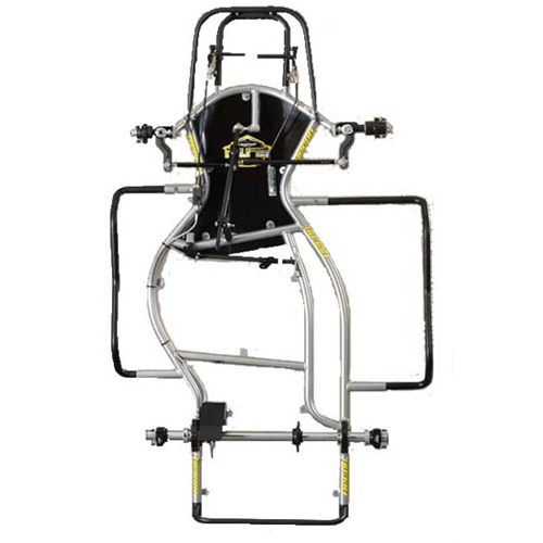

Dirt oval karts are typically offset. image http://www.tsracing.com/Assets/ProductImages/PhantomRecon.jpg
Sprint:

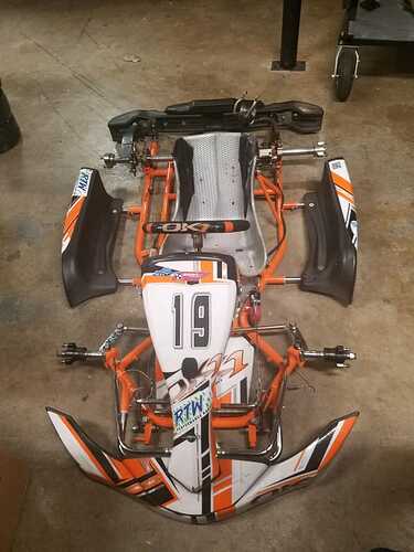

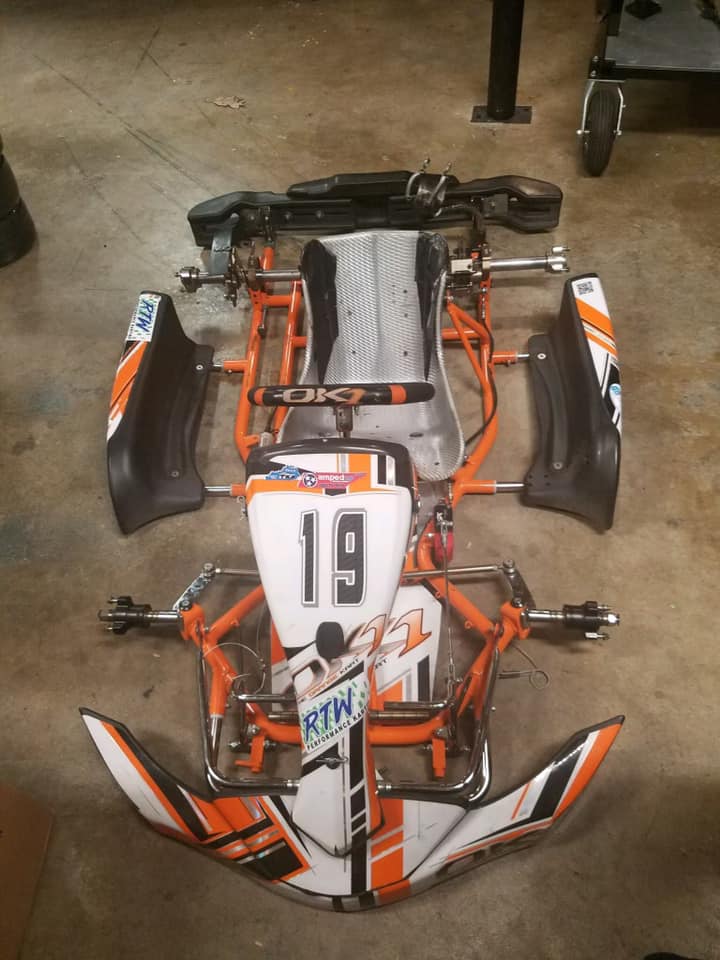

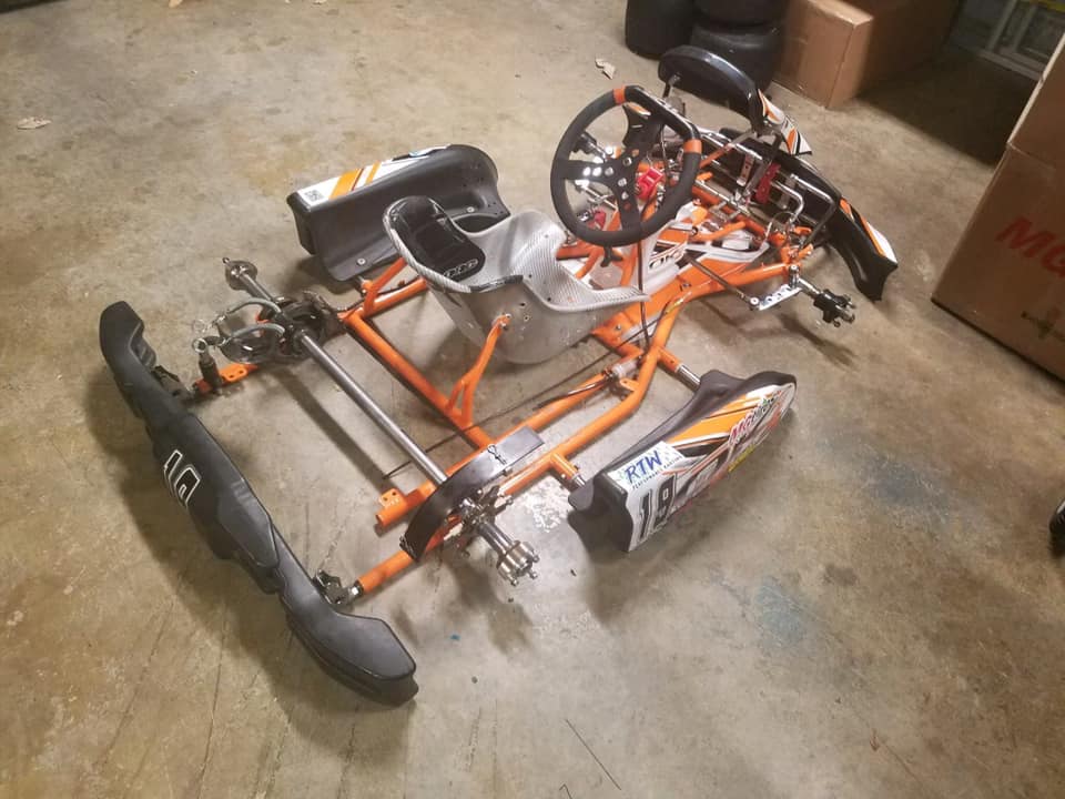

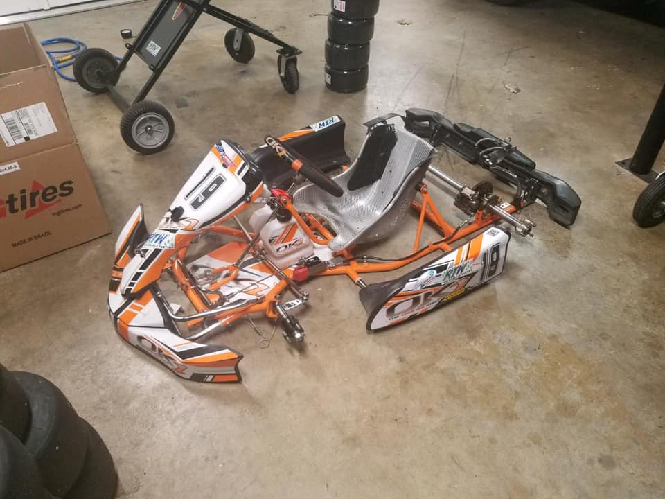

Attached are some photos of the first kart an OK1 with a clone engine which is what the kids run at the track in Saltillo, MS. Everywhere else they seem to run the LO206 in the kid classes but that just seems like too much engine for the moment. We are going to go take a look at it this weekend if the weather holds out maybe test at the track!
Having started in adult size karts, I have no clue. However, the 19 doesnt look like a kid kart to me.

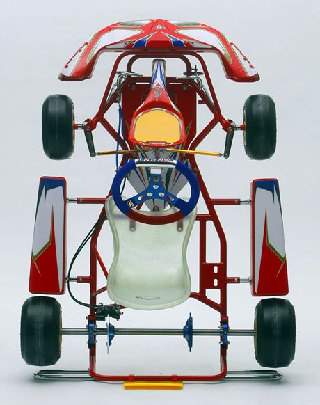

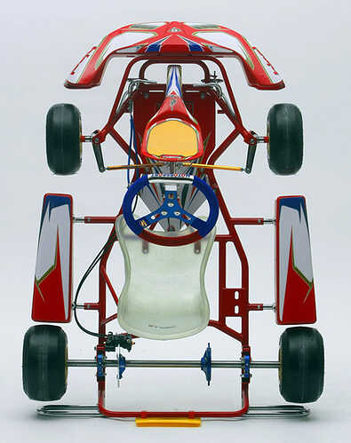

Here’s the birel kid kart vs cadet.The top is kidkart. You can see how much shorter it is.

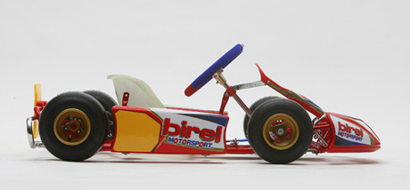

Side view of kid kart:
,Wheelbase.
Birel B25 ‘kidkart’ 78cm.
Birel C28R ‘cadet’ 95cm.
Typical ‘adult’ kart 105cm.
I know scale can be hard to tell from pictures sometimes, but generally (at least most I have seen) kid karts will have both front hoops (bars the front bumper attaches to) welded to the chassis and in junior and up they (or least the upper) are bolted on.
Also Kid Karts do not usually have a fuel tank under the steering support. They use an over engine mounted tank. There may be very few exceptions to this rule for certain engines that do not support that.
I’m going to go out on a limb and say that is Cadet Kart I posted above.

As mentioned the wheelbase is different between cadet and kid karts. The one you posted seems like a cadet. Again check the rules for your clubs as some won’t allow cadet chassis in kid kart classes.
I don’t know much about 206, but I believe there’s a different throttle slide for kid karts that will further limit the power over cadets.

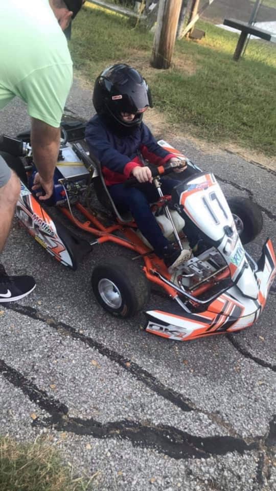

I am gonna guess the 17 with your boy is a cadet kart with pedal extenders.
Correct from what I understand there is a slide that really makes it quite tame for a little dude starting out.
That’s not my kid on the kart but I bet that’s about how he is going to fit on that kart. I believe you’re correct that it is a Cadet Kart. I’ll probably pass on it.
