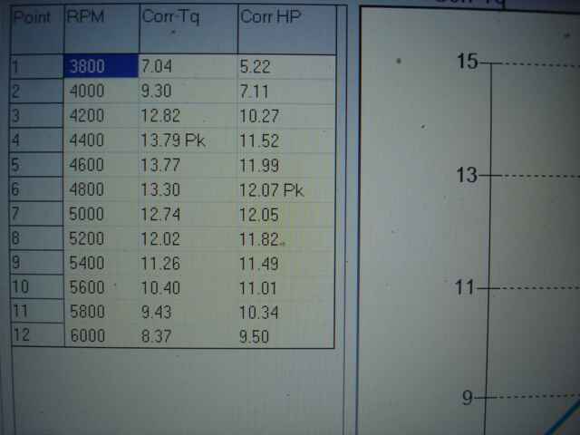

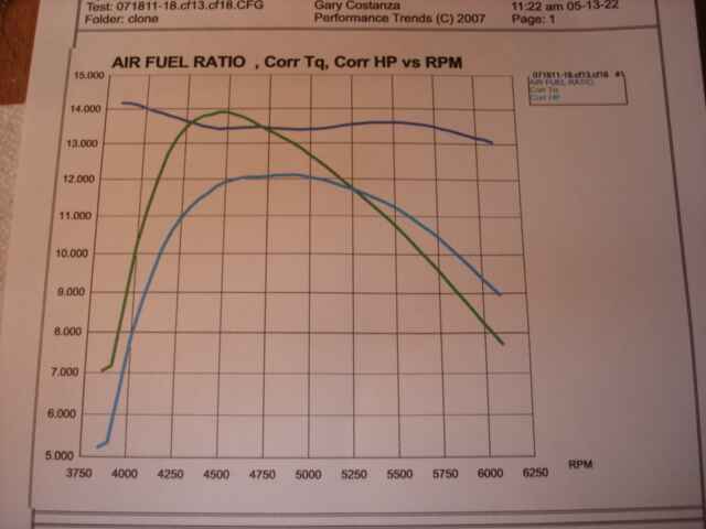

Dyno numbers from Gary Costanza. I think he’s going to do same with a 206 for comparison.
12.07@4800 , 13.79ft lb @ 4400 (The torque seems to fall off a cliff pretty fast though)
From Gary..
“Nice little motor . No issues out of the box . Idled down to 1300 and ran rich thru out the pull . Well tuned little carb. Out of the box the Ghost’s carb is tuned very good . As I dumped the throttle , the mix got richer . Thats what everybody whats their carb to do . When they go lean , then pickup , that gives you the dreaded “Bog” . I really can’t pickup much from this in fine tuning”

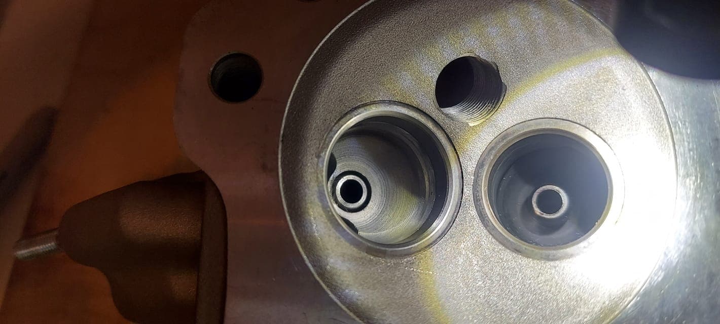

Head\Valve Details from Bryan Wesley
Charlie Zothner the intake port bowl area has a way less intrusive valve guide in it. The valve guide doesn’t protrude in to the bowl area of the intake port. As far as shape, nothing crazy different. As far as air flow, big difference.
