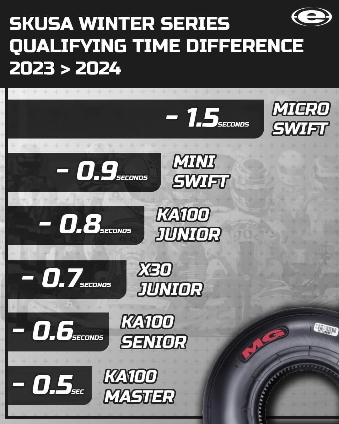

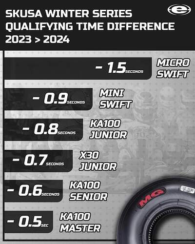

Thanks Ronald, and please bear with me, but to make sure I’m interpreting this 100% correctly – 2024 times were less than the 2023 time by the amounts shown, or where 2024 worse than the 2023 times by that amount? UPDATE: I see now
Data backs up what the karters were saying about the new MG Tire SH2 compound at the Superkarts! USA Winter Series opener in Homestead, Florida. Qualifying times from 2023 to 2024 were much quicker across the six categories that utilize the new compound. EKN will continue to monitor the speeds of the SH2 at the second event in February.
Boy, those are massive time differences. It’s like the difference between Red and Yellow. I wonder what the drop-off/longevity is going to be like.
2024 times were faster.
Possibly reading too much into it… but that chart seems to be a great example of the load sensitivity of tires given it fits perfectly with class weight and speed.
