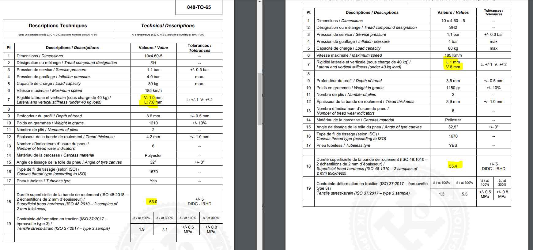

New MG Red SH2 for 2024
Homologation sheet for the new for 2024 MG Reds (SH2), 7.10 rears
Homologation sheet for previous MG Reds (SH), 7.10 rears

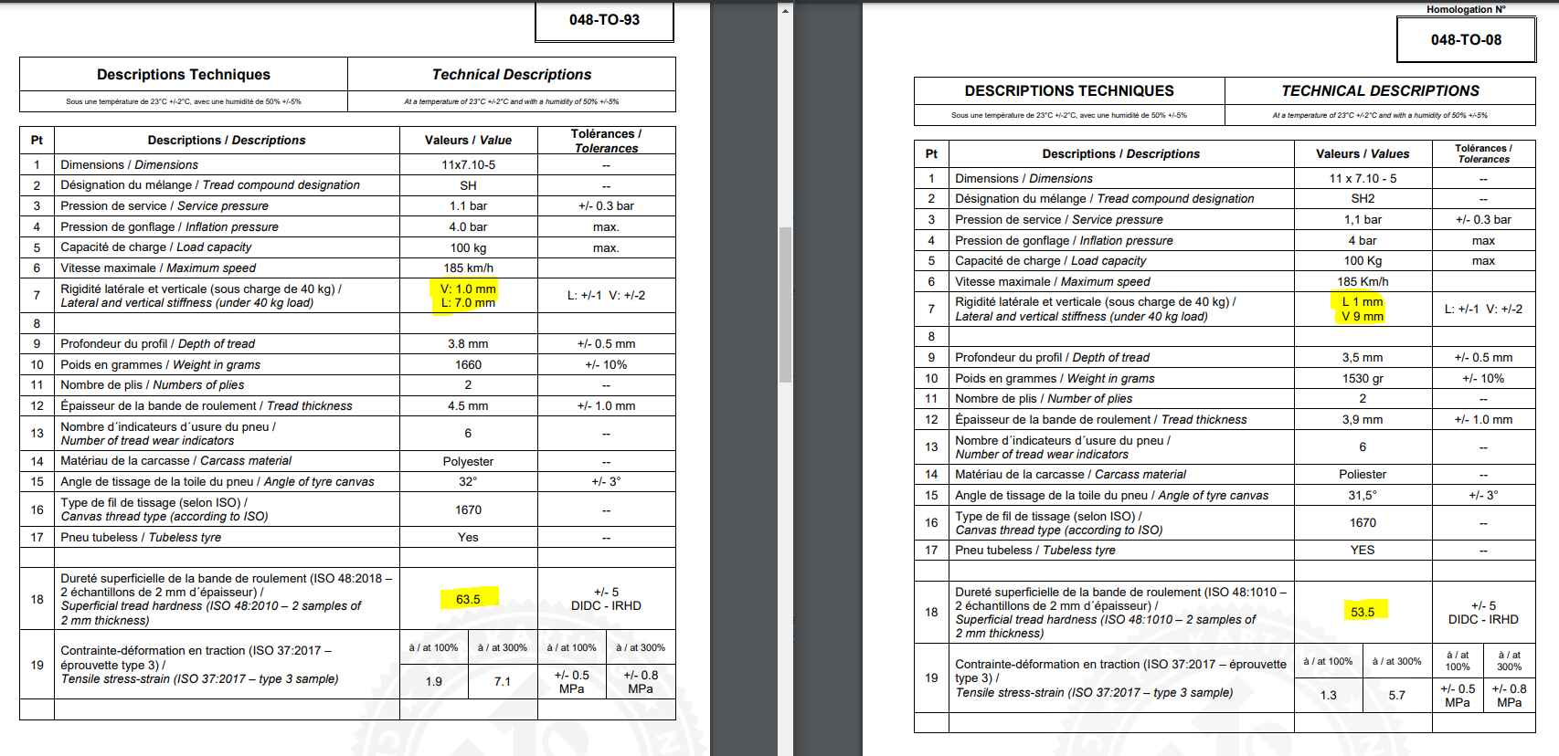

Here is the SH2 front tire specs
It looks like, new tires are softer, stiffer, heavier but potentially last longer?
Good catch, I hadn’t noticed that size difference between the two sheets I posted. I’ve corrected my first post to now include the notation for size, and also included the link to the older rear spec (which wasn’t included before). That durometer tho…wow
Softer sidewall and softer rubber Top is front tire bottom rear, Left old compound right new
