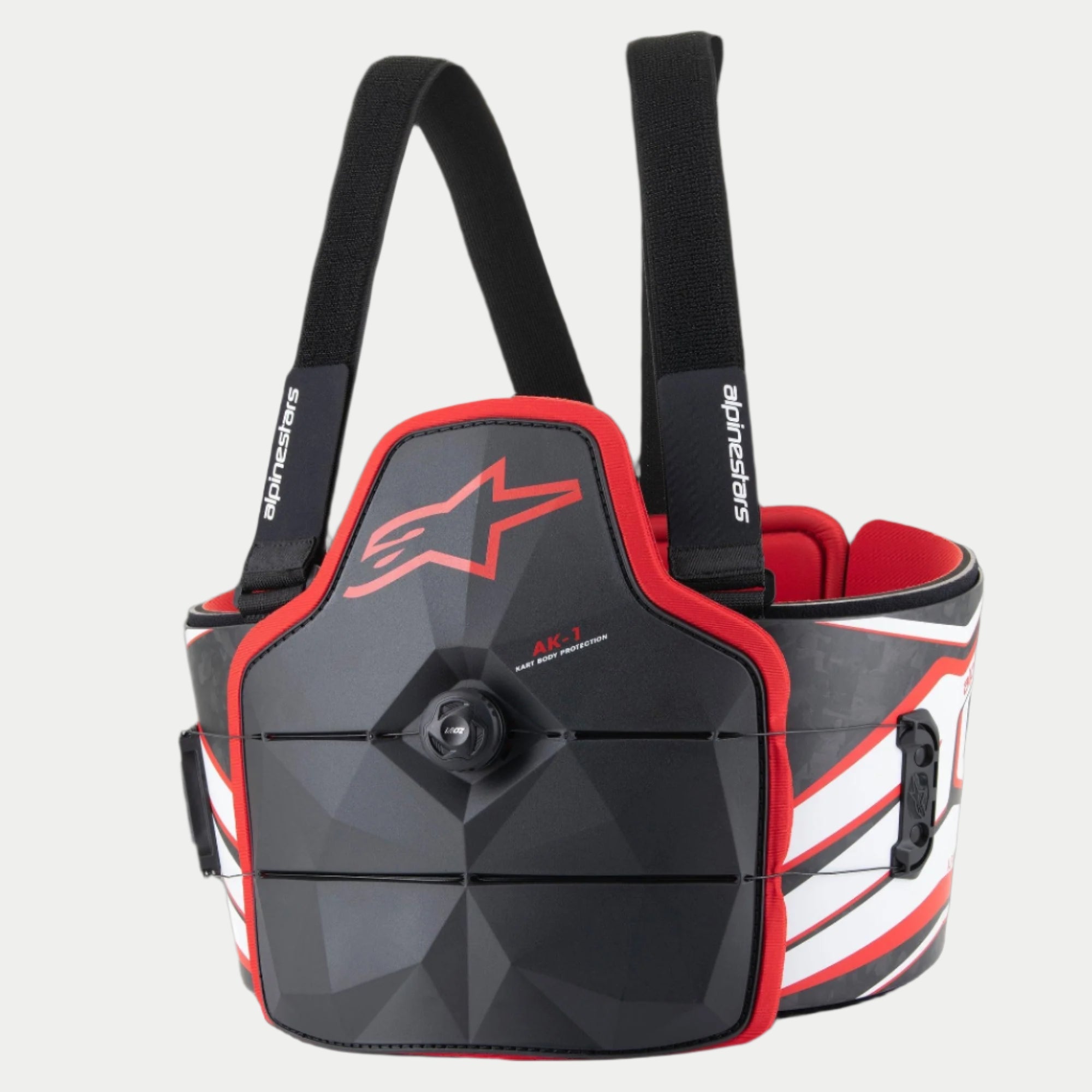

New rib protectors with sternum plate?
Anyone tried out the newer rib protectors with the sternum plates? Anyone found a good one? My bengio is starting to go soft and I’m looking for a new rib protector but I think that extra plate will drive me crazy.

The sternum plate originally was only for the little kids who sit right up close to the wheel and have no arm strength to mitigate their inertia in a wreck like this, so they go right into the wheel with their chest.
Less necessary for adult drivers who can brace themselves more and sit further from the wheel, but still worth protecting, as sternum injuries can be really bad.
That makes a ton of sense. Since Nick started around 10, I missed the munchkin stage. I can see what you mean about how their arms are short, they are much more upright, etc. They probably hinge more at the waist, are right up against the wheel, etc.

They’re required for all ages at International events. I have the Bengio version, and I honestly don’t even notice the chest plate when driving.
Not to be morbid, but the only death I’ve witnessed at a kart track was the result of a broken sternum over 25 years ago, when a kid took a shot to the steering wheel - so I’m all for the safety they provide.
The KBP (Karting Body Protection) systems have been mandatory ever since 2021 for International Events, for all ages (from Junior to Masters)
They have been developed following roughly 4 years of development between the FIA’s safety department and the rib protectors’ manufacturers and are homologated to respect / withstand specific load cases in shock, of which the values have been acquired through lab testing with dummies and crashing karts to simulate incidents :sweat_smile:
The forward plate is indeed to protect the sternum, which was identified as being a critical body part that was not fully protected in case of a steering wheel impact.
The full list of homologated KBPs is available on our website, here :

Right now I’m looking at either the Tillet or Bengio version. I like the adjustable back piece to the Tillet, but at the same time my Bengio has been bullet proof. :man_shrugging:
As the Rotax Grand Finals are on the FIA’s International Calendar (and as such abide by the CIK-FIA’s regs), i confirm you will 100% require an homologated KBP to race.
Well my son tried one, and lets just say that he is not impressed😬
He went out, did 15 laps, came in and told me that unless i demanded it, and had really good arguments for it, or it was demanded by the rules he was going back to his Bengio :man_shrugging:t2:.
Definitely required at the Grand Finals. I bought mine for the 2021 Grand Finals, but they delayed the requirement until 2022, when I lent mine to a friend to use.
