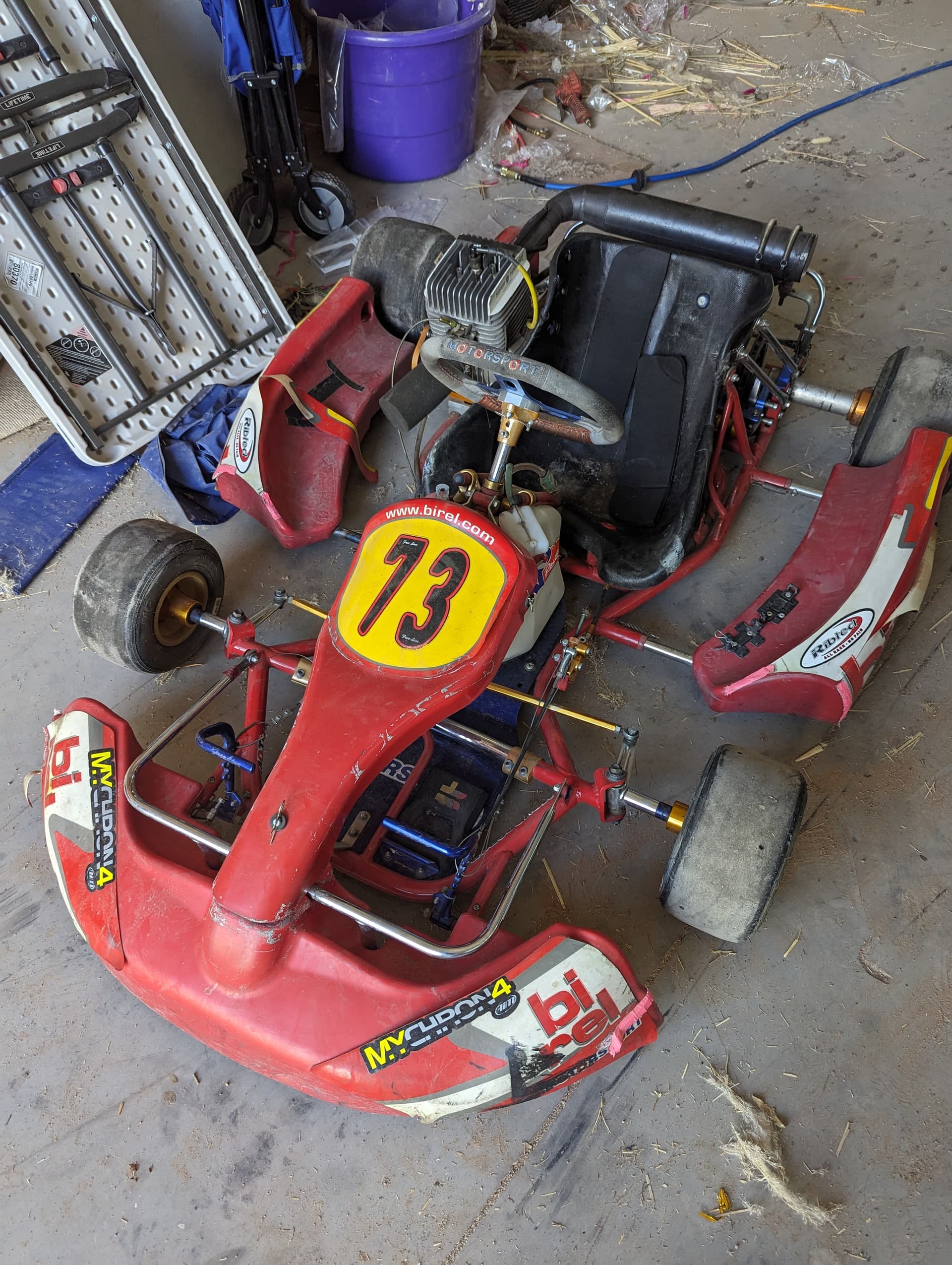

Finally found a good deal on a Kart - needs work, but that’s okay with me. He included 2 starting devices. A few unknowns I need help with:
  • This is an alcohol engine - after research it seems I would be better off starting with a regular gas engine to get the feel of things (maybe a predator?). Regardless, I think it would be fun to feel the alcohol’s power before converting. Where can I find more info on purchasing methanol, finding mixture ratios, etc? I don’t know much about this engine.
*Are the predator ghost engines directly compatible with my setup?
*What else should I know about this go kart and where can I find documentation?
Thanks all!

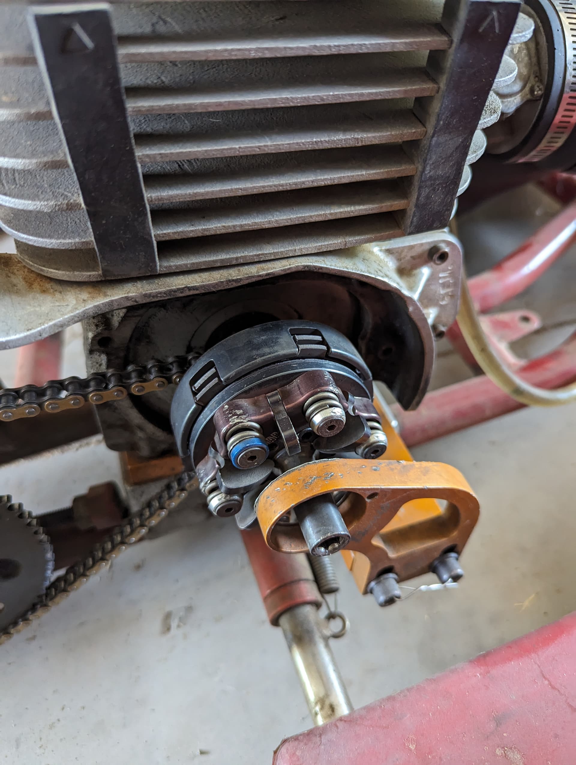

Also - it needs a clutch, where can I find a rebuild for this thing?

Clutch looks like a typical Horstman two-disk which I’m sure most kart shops have some spares in their backrooms for.
I would concur with everything TJ is saying.
That looks like a horstman for sure, not sure if they are still around but their website exists:
http://horstmanclutches.3dcartstores.com/

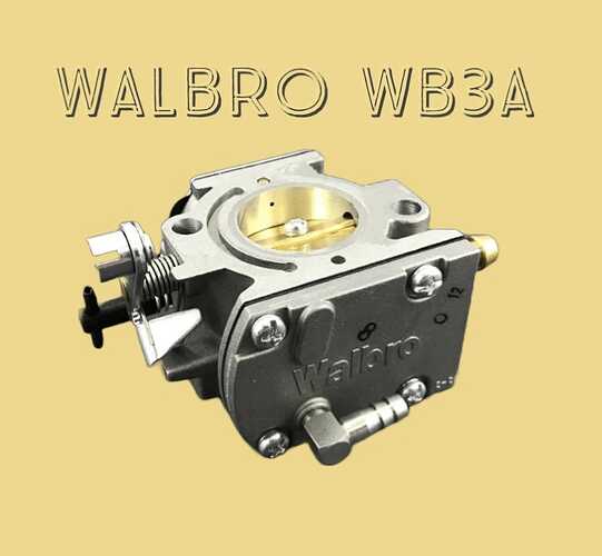

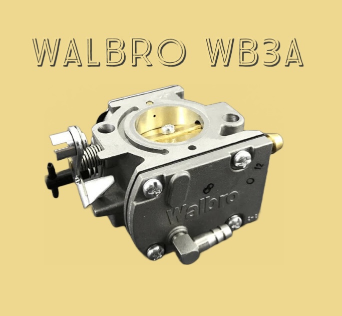

Likely the carb will need a rebuild if has been sitting for any length of time and that could be causing your issue. Its really the diaphragm more than anything. The kit should be readily available. Here it is from Comet:
Happened to have this premade.
Thanks TJ and Robert for the carb info, what you describe makes perfect sense based on what I was attempting yesterday. I’ll order one of those rebuild kids. Cool site!
As far as the clutch, I couldnt find one that matched any of the horstman’s, but I did find an emblem on the clutch saying Tomar. After researching I think its a Tomar TD-23 but not positive…
You may be right. The shoes on the clutch look to match the Tomar whereas the Horstman had more squared off shoes. I ran Tomar stuff for a bit too. They had a cool multi-disk dry clutch I used for Yamaha pipe when everyone else was running wet clutches. They make good stuff.
