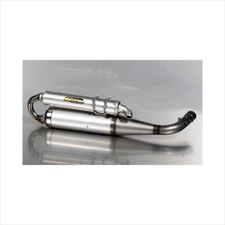

one specific track here has very tight sound restrictions, Laguna Seca. This is the silencer which is built for CR125 karts that run that track:
https://www.fastech-racing.com/rlv-silencer-laguna-seca-spec.html

Thank you, thank you to this thread and to @Dom_K1 for helping me find this thread. I’ve spent several hours searching over the past week or so trying to figure out how to quiet my kart down, and this is what I’ve been needing the whole time. Here is a direct link to the auxiliary RLV silencer kit (shown above), which seems miles ahead of anything else available for these type of purposes compared to anything else I’ve seen (which is pretty much nothing).
