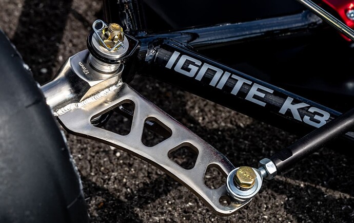

I’ve got a Margay ignite K3 and started using offset camber pills. After getting everything aligned and going out on track the pills both seem to shift and throw off the alignment. If I tighten the kingpin more the pill moves with my steering input. Any guidance on how to keep the pills in place?

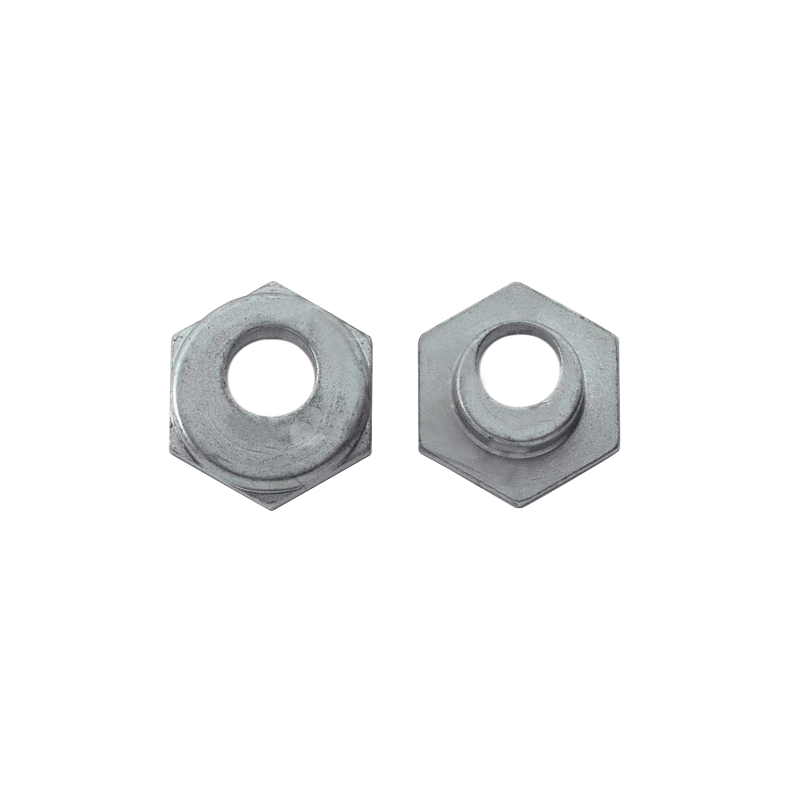

If you make sure that the spindle spacers compress on the INNER RACE BUSHING of the bearings, you can crank down on kingpins pretty tightly. Make sure you’re not compressing the bearings, though… There should be a spacer inside the spindle barrel to keep the bearings apart, as well as either a skinny bushing or stepped spacer above and below to ensure the bearings don’t get crushed. My old Birel had a hex shaped ‘eccentric’. You can sometimes buy other styles if yours isn’t holding… I bought these to use:
These worked for me, but if they didnt’, I was going to buy the “perforated disc” style, and drill a single hole and tap for a allen head screw to hold. Usually there’s enough meat in the ‘diagonal’ to place a single or possibly opposite holes for the ‘new style’ eccentrics. Measure 3x, drill 1x…

Thanks for all the replies. I went straight to the source and reached out to Margay. Turns out my issue was the placement of the hardware inside the C frame.
I was wondering that. If the washers are too wide or in the wrong place it can turn the pill. It can also lock the steering down under load. It sucks when it happens.
Also, on the topic of sniper plates: Snipers SA1 Base Plate ONLY - HARDENED - Fastech-Racing
So, what’s the proper order?
From top to bottom:
Kingpin nut
Thick washer
Pill
Frame
Spacers
Thin washer
Spindle
Thin washer
Spacers
Frame
Pill
Thick washer
Kingpin head
The important part was the washer thickness in order to get it to sit right.
