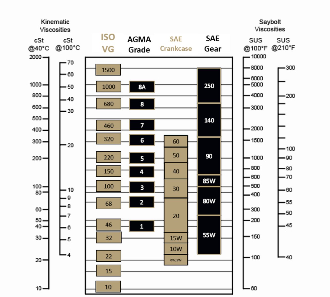

The only time an oil number means anything directly is when an oil is reported as an ISO number. When it is the ISO roughly equals the viscosity in centistokes at 40C. SAE standard viscosity grades are crazy wide ranges. 20 grade SAE can be anywhere from 35-70 cst viscosity.
The W does indeed mean winter. And the method for specifying the W (or cold cranking) grade for SAE motor oils is not straightforward or consistent. Each W grade has a different temperature that it is reported at in accordance with SAE guidelines.
Thankfully the applications I used to deal with didn’t use any archaic AGMA of convoluted SAE specs and instead all followed ISO. Much much easier to work with!
The chart below crosses standard SAE grades to other specifications.
