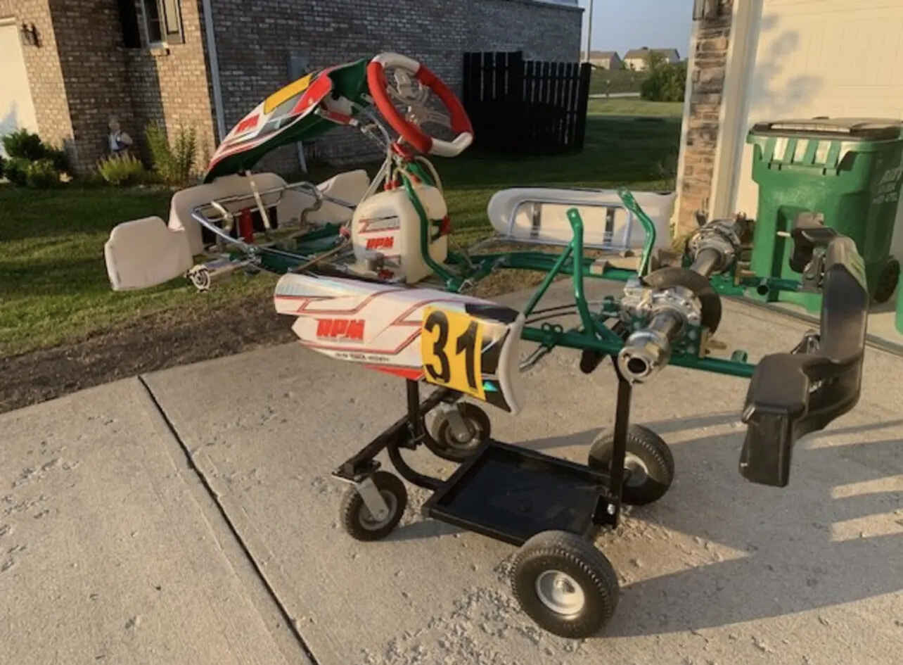

Agreeing with the replies here I started looking for another Tony Kart. I am Indy this week for work and found a super clean 2022 RR and grabbed it!!
I will be back again in 2 weeks and it will be put In the hauler and brought home to AZ.
