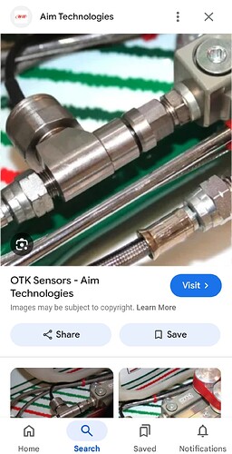

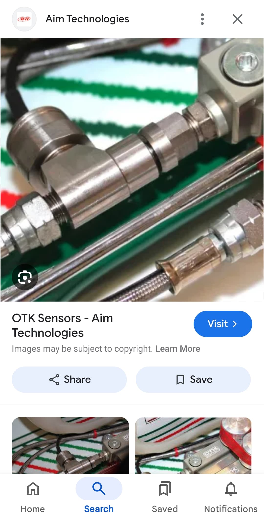

I recently bought the AIM OTK Brake pressure sensor. It came with just what looks to be a copper washer between the sensor and fitting. I tightened it, it leaked. I tightened a bit more, it leaked. I tried going more and stripped it out. Bought another one. Same thing. I’m at the point now where I feel like if it’s any tighter it’ll strip out. What can I do to fix this? Teflon tape (something for hydrolic lines) or locktite?
Here’s the sensor I’m talking about.
It is leaking between the sensor and the adapter?
When does the leak start? Immediately after installation? After some use?
The crush gasket between the sensor and the adapter is new?
Wonder if you have a bad adapter.
It just has a copper washer. It doesn’t look like a crush washer. I’m also wondering if it’s just a bad sensor. I can’t tell exactly where it’s leaking from. I’m pretty sure it’s where the sensor goes in though. I may try some 567 Loctite…
You said you replaced the sensor and still have a leak. Yes? If so relaxing the sensor doesn’t seem like the right thing to do.
I got ahold of AIM tech support and they said to use thread sealer like 567 Loctite to prevent any leaking.
