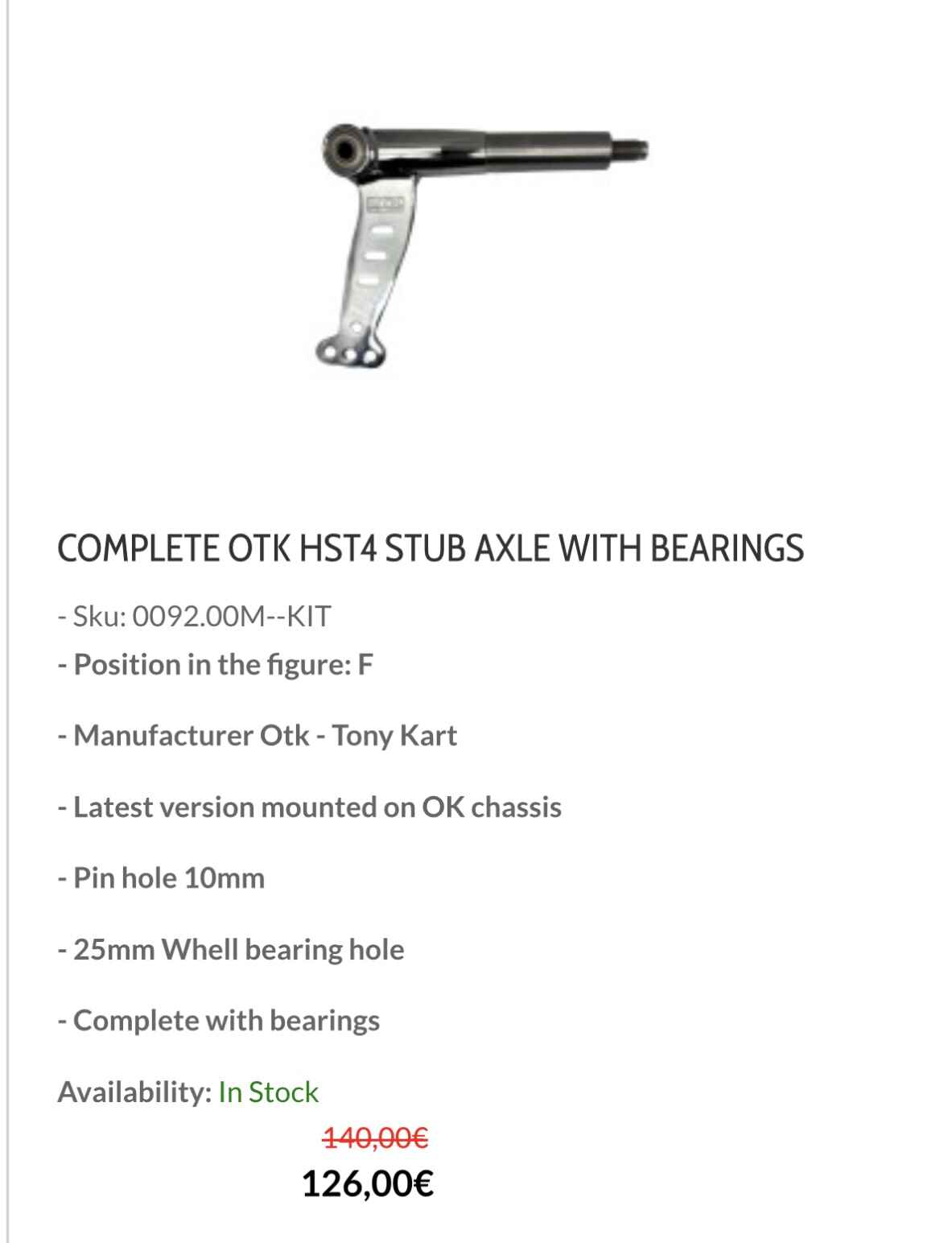

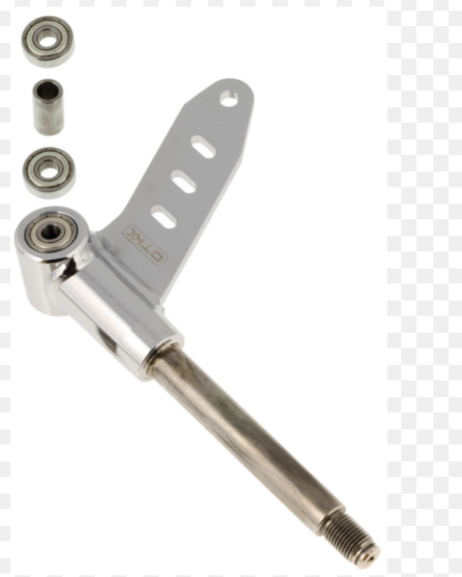

Hello, I found this piece and I want to understand what its usefulness is and if anyone has worked with it could you give me your opinion and above all help me understand what advantage it has vs the original that comes with the original.
I attach the two images
ORIGINAL
HST4
It just gives you even more steering geometry options, I’d say unnecessary since original already works great
The most obvious difference is the bigger cross-section, which will make it stiffer and transfer more flex to the chassis instead of absorbing it in the spindle… and the aforementioned hole options (assuming they’re in different locations.)
