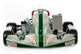

The most obvious change I can see is the move from the 2014 M4 to 2015 M6 bodywork.
I.E. 2014:
image https://encrypted-tbn0.gstatic.com/images?q=tbn%3AANd9GcRGI6j6c5SGYtyBg4MXtS7ldd4uNNOEBeoWTw&usqp=CAU
2015:
image https://encrypted-tbn0.gstatic.com/images?q=tbn%3AANd9GcSLf0oF6ISiFtNyiCGasnUmKqbklbD3lef9pw&usqp=CAU
