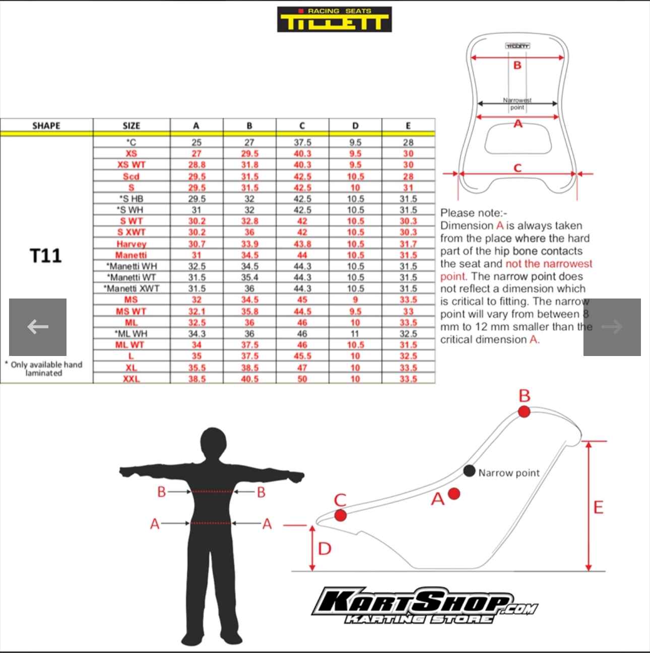

Looking to buy a Tillet T11 VG.

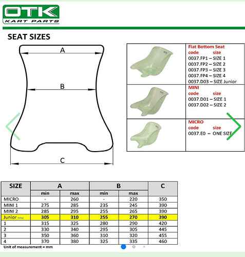

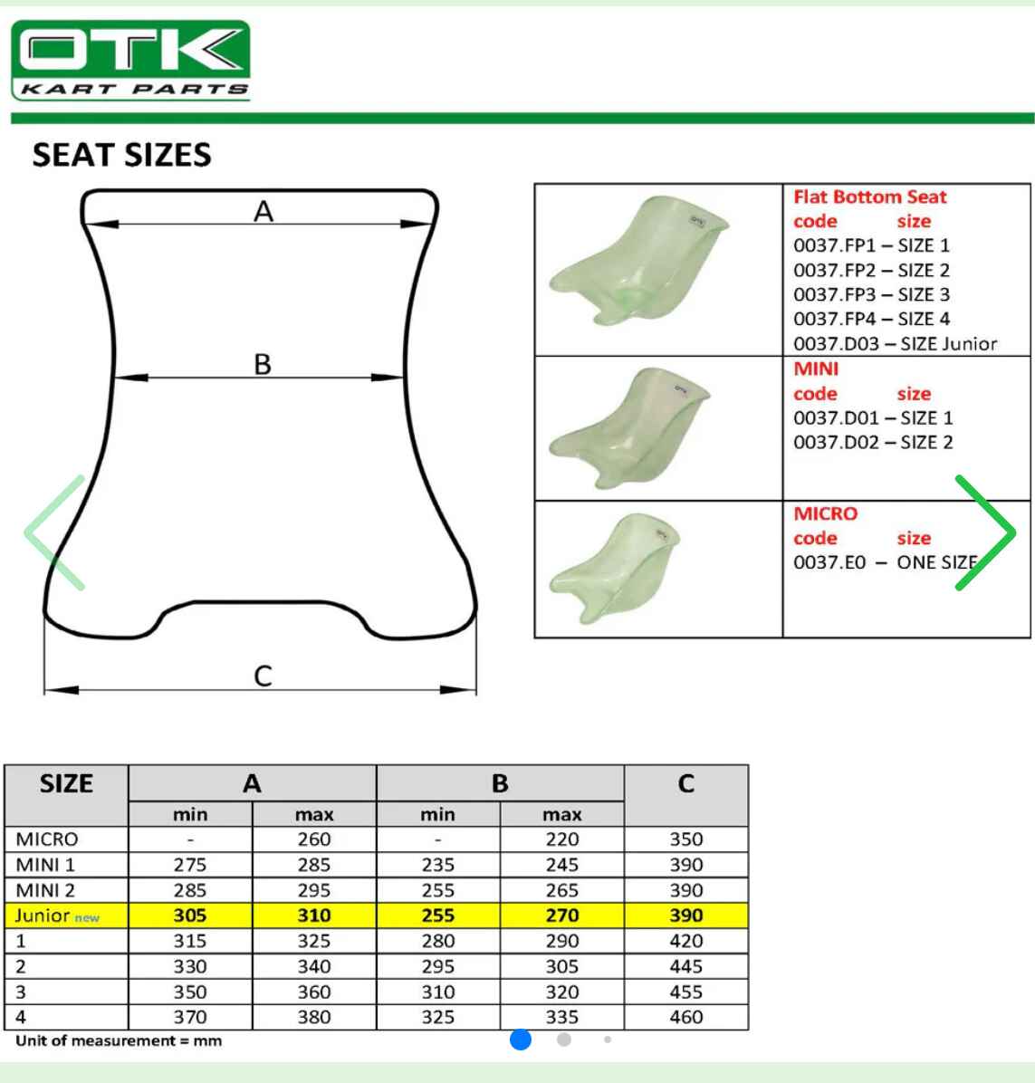

Does anyone know what size corresponds to an OTK size 3 seat, had not much luck contacting Tillet.
A bit wider on the ribs would be ok, but definetly not smaller.
Thanks!
Just compare seat charts. Find one that’s close to a size 3 bet wider in top dimension.
as I’m sure you know all of these seats have a slight variance even the same size seat from the same source. My brother and I both used to run size 3 OTK seats and have moved to Tillet. I think the ML is the most comparable to a size 3. That said, the Size 3 was tight on me and the ML was just as tight in different areas and started to cause some rib pain from really being compressed in the seat. I have since changed to Tillet size L instead and I’m much more comfortable in that seat, might be a touch lose but no rib pain since the switch. My brother tried the Tillet L and thought it was too lose and went back to the ML size. So if OTK is a good fit odds are you’ll like the ML. If the size 3 is tight on you you’ll better fit into a Tillet L
