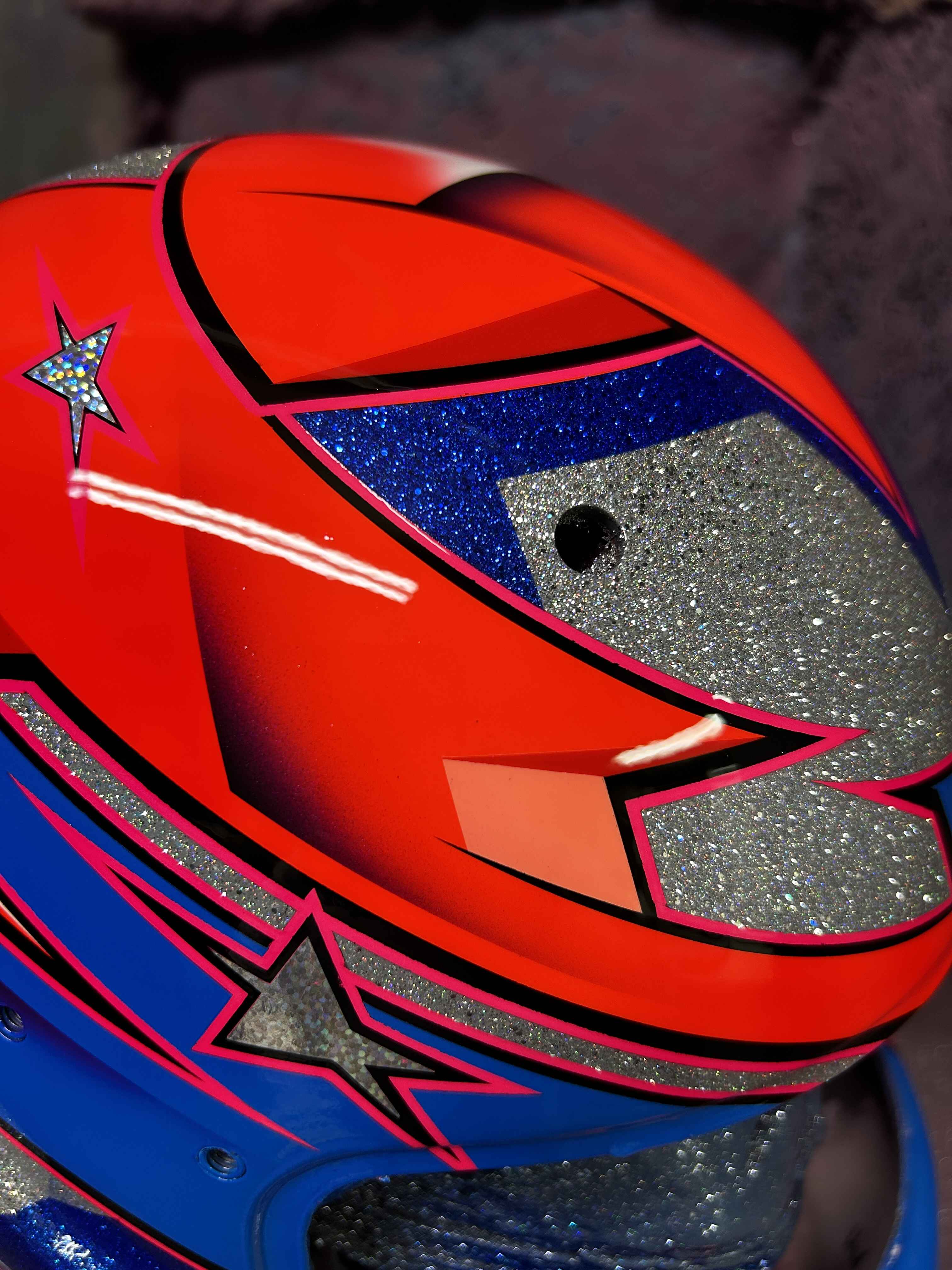

Coincidentally I am doing flake this week. A few sizes of silver mixed together with a little iridescent mixed in too. Then candy blue shot over that and the stars are holographic vinyl.

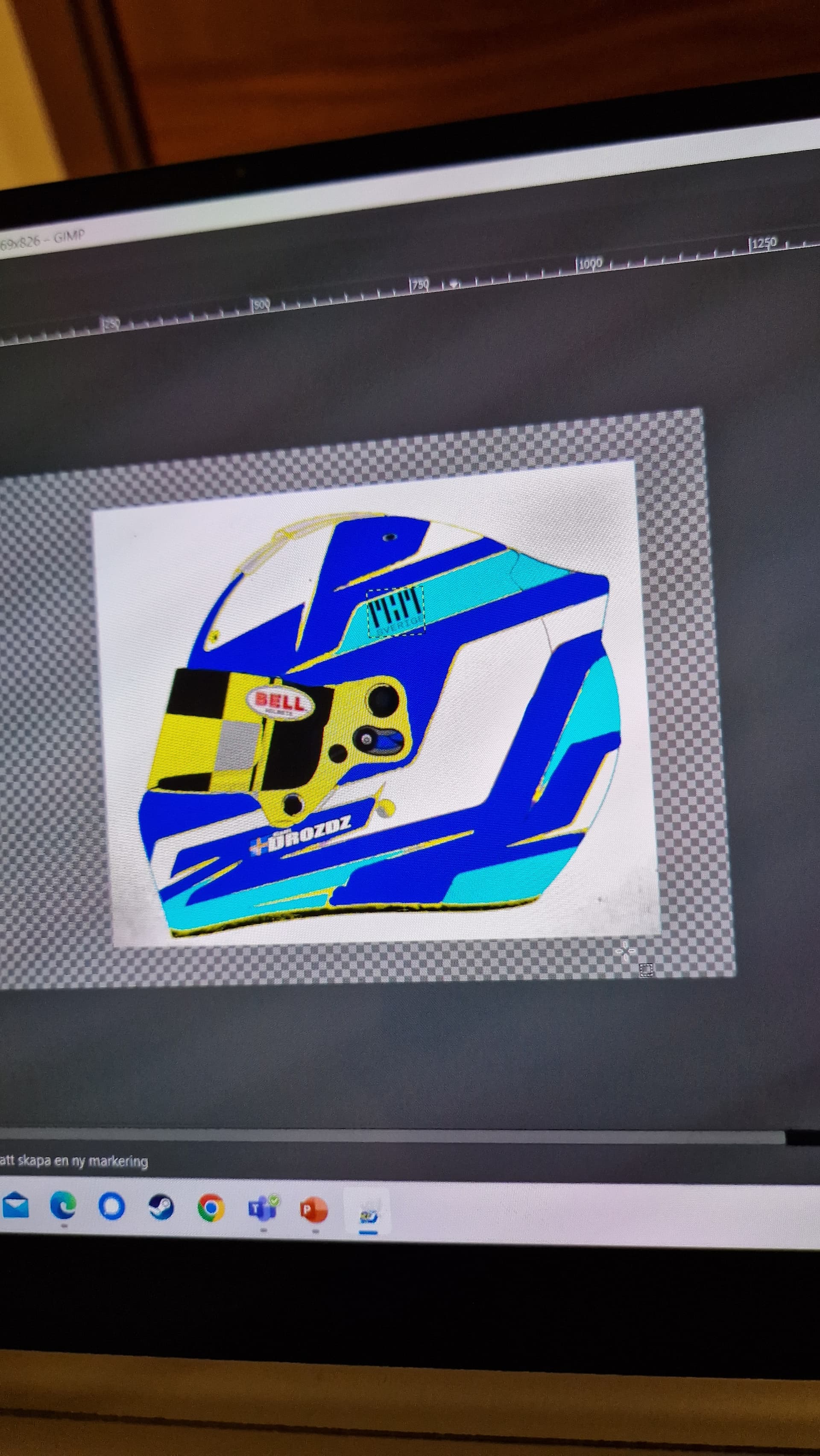

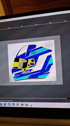

Im in contact with a painter and i want to have gold holographic lines (flakes) je said vinyl is best option what do you think?
Muck up design i did in gimp
If just doing the lines in holographic then yes vinyl is the best option.
Then the cyan in chrome i think it would be cool

That really is pretty. I like the stars a lot and the red/blue colors are really nice ones.
