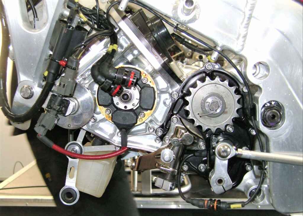

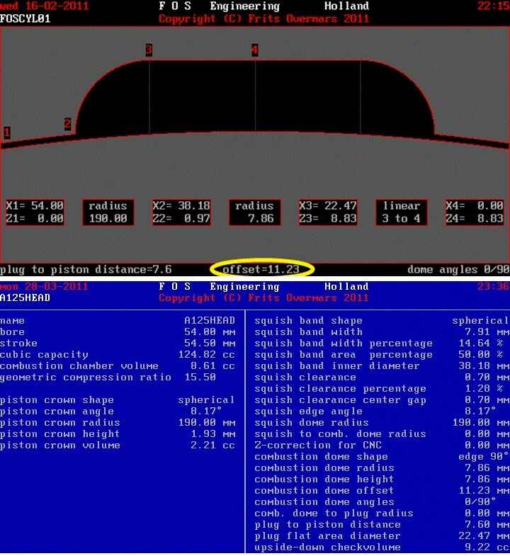

For me, the balance shaft and oil pump caught my eye. Not to mention the head volume of 8.x cc. Front rotary we’ve seen in karting of course. Not sure what the oil pump is for as it was a premix engine at 5%

Balance Shaft, Oil Pump, Detonation Sensor
Oh my that’s a work of art…you were asking why the oil pump since it’s premix? In that version, the pump picks up oil from the gearbox and pushes it into the gear&pinion that transmits rotation from balance shaft to the shaft that moves the rotary valve, as the two shafts are at 90 degree angle. Oil is needed to keep the gears lubed
