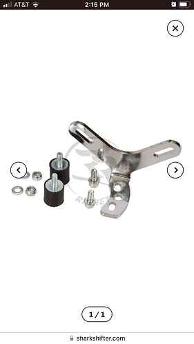

No worries, just had be confused lol. I think I need a shorter wheel hub to bring the clutch handle closer, but shifter came in today and I will figure it out. On another note, has anyone ever used one of these fuel pump mounts? Any idea how they mount? :joy:
