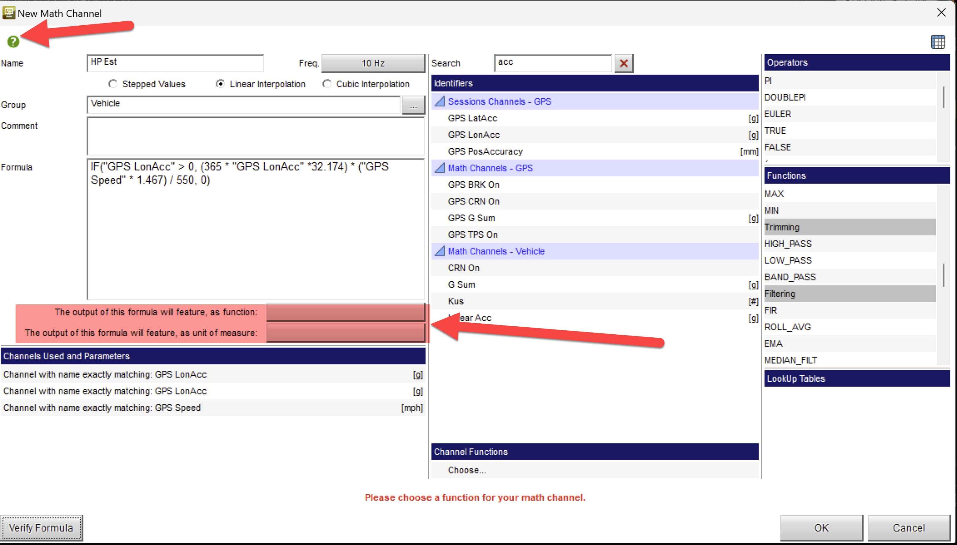

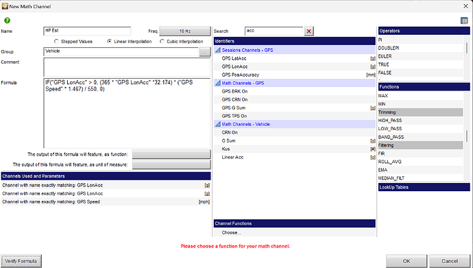

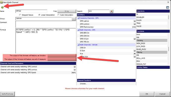

Below is what I have. I intend to play around some more with some math channel stuff, this is just my first foray into it.
Note the red error message….and I am struggling to find decent instructional material on doing anything with this.
Fill out the highlighted area for the function and units. Also note that if you click the green button top left, you can get to the help files.
Thank you. I found the help files, but no solid step by step. Filling out the boxes at the bottom got me what I wanted! First step to playing in depth with some data.
