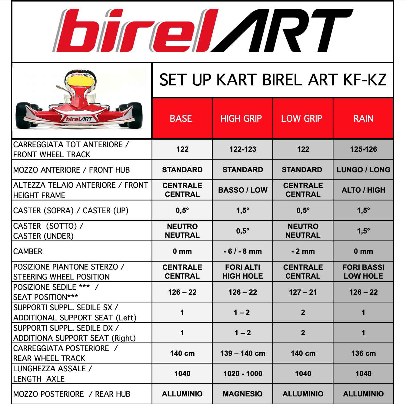

.Here is the BirelArt set-up sheet which recommends both aluminum and magnesium for different conditions. The problem that I have had with short 70mm hubs is with cut axles they don’t leave a lot of axle for the hub to sit on / fasten to.
