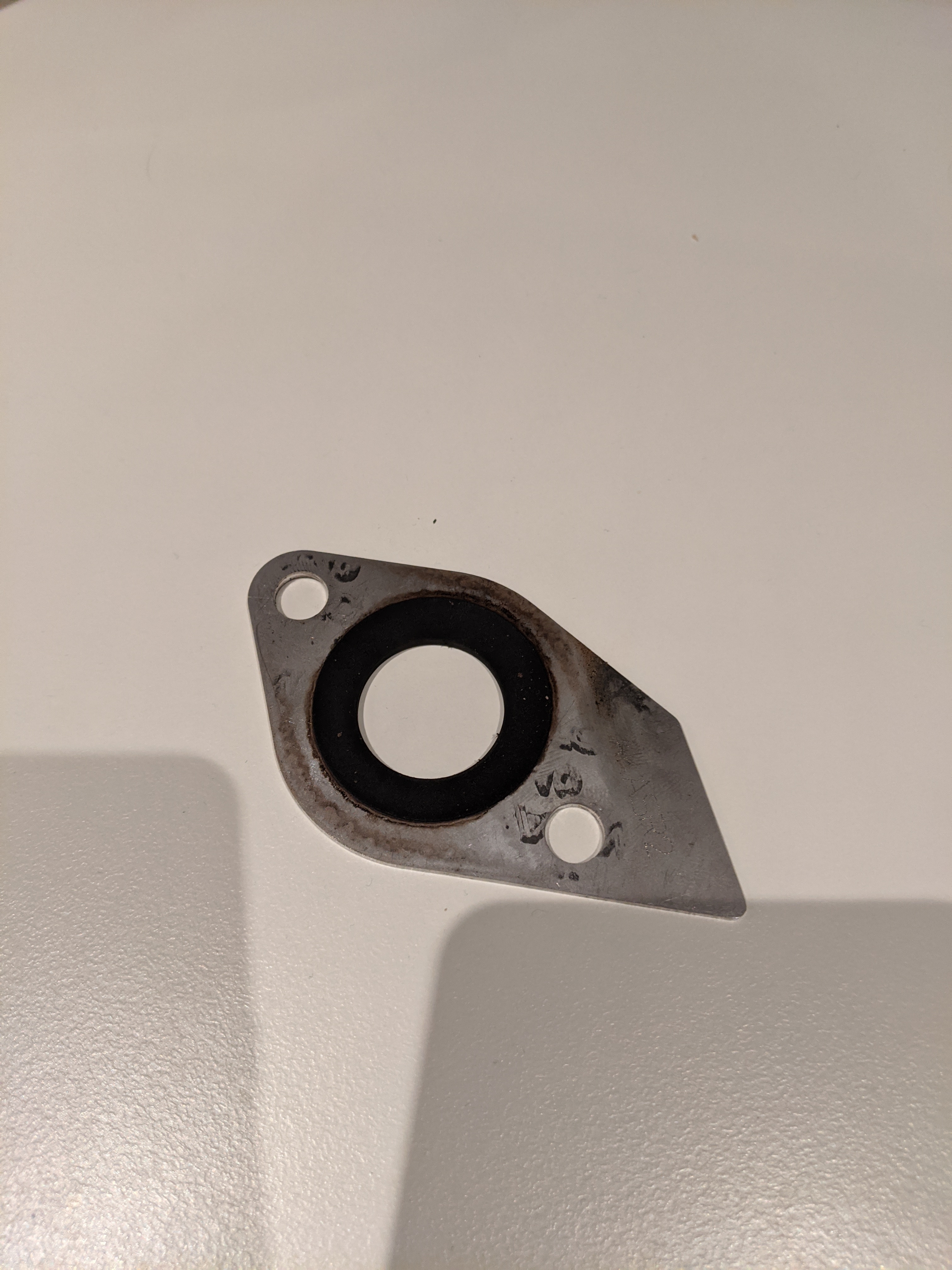

Removed restrictor from Rotax senior max
I’ve just removed the restrictor from my Rotax senior max. Is there something which should slot in instead of the restrictor plate like another gasket or something?
Nope…the one gasket site between the exhaust flange and the cylinder…thats it
ok cool thank you for that
I know this is an old thread, but is it common in all countries that the Senior (max) engine has a restrictor?
I have actually never seen a restrictor like that one…
No its not something thats commonly done, I know in Australia they run it but generally speaking its not something thats done
Yes I know, it’s strange why they do it here? Do you know why?
Its done for club racing where the class offers the opportunity to drivers who aren’t physically fit enough to run the unrestricted class which also uses softer tires (more g’s). Its basically for those that want the benefit of close racing but just aren’t up to speed with the senior/master guys.
