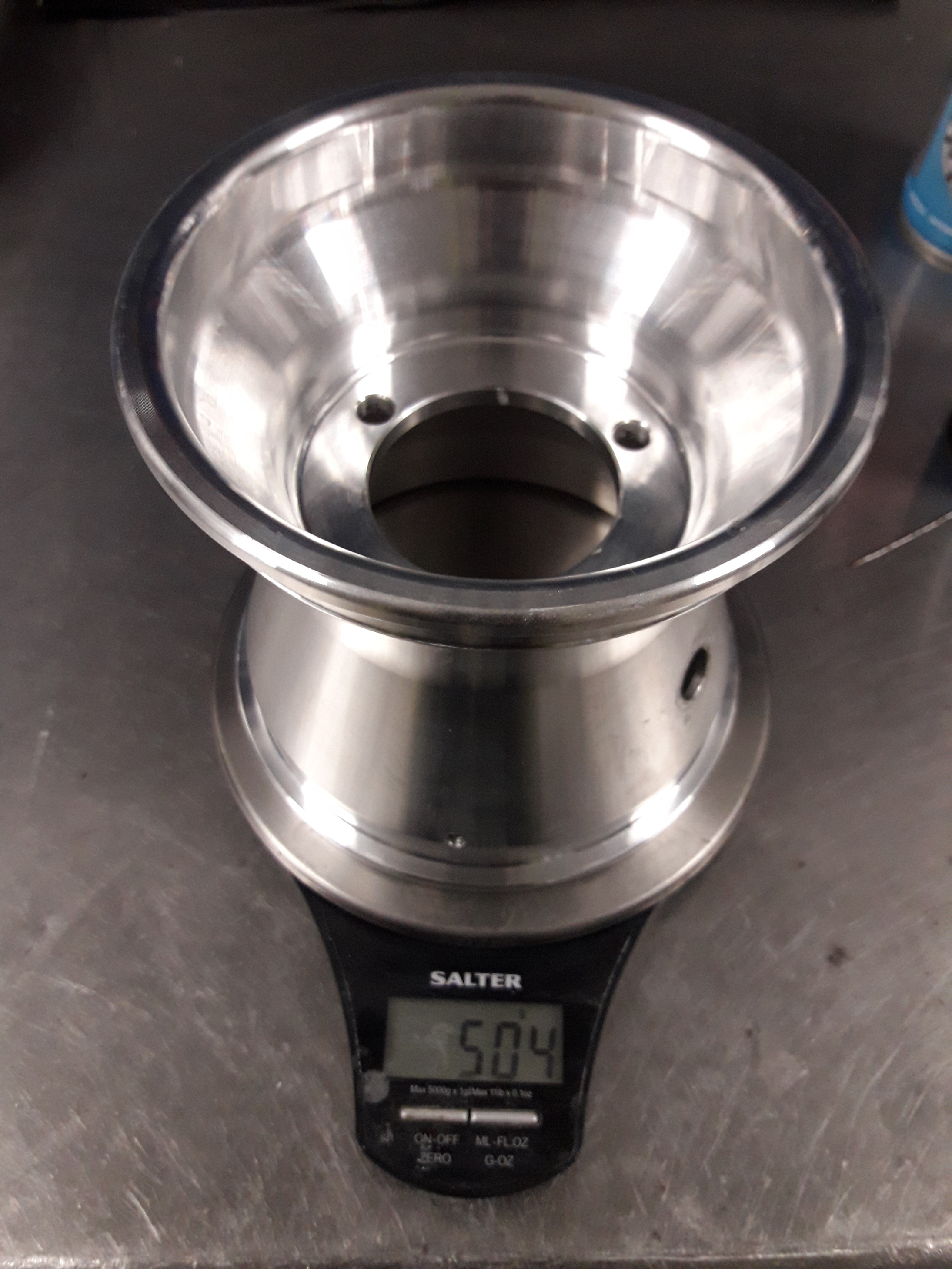

Bright alu wheel Righetti Ridolfi

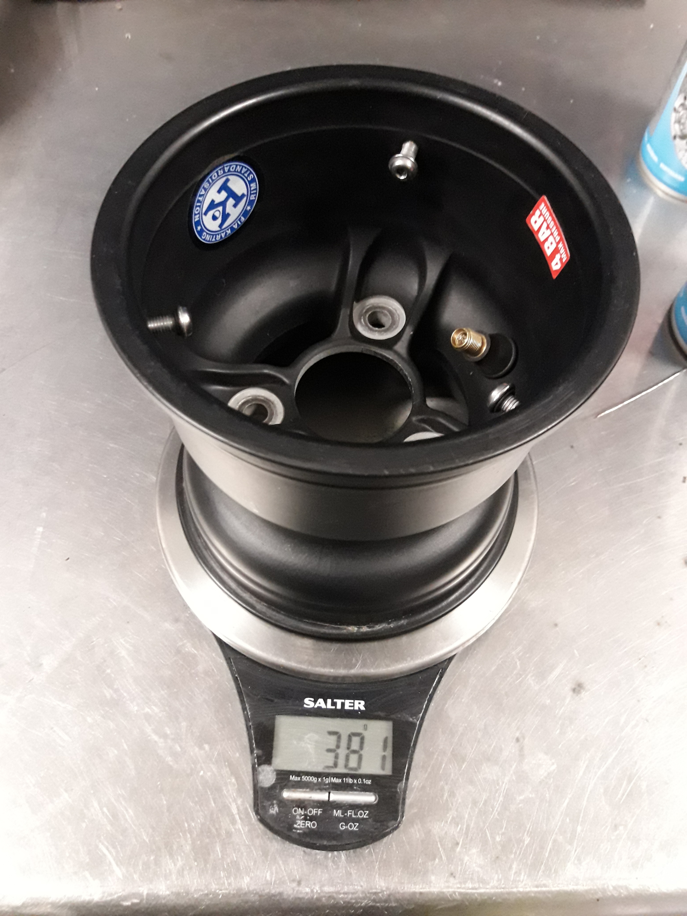

Black mag wheel made by Douglas
Alu wheel felt really heavy so compared it to mag wheel on scale. Results : 504gr vs 381gr
I dont know how wheel weight affects go karts handling
