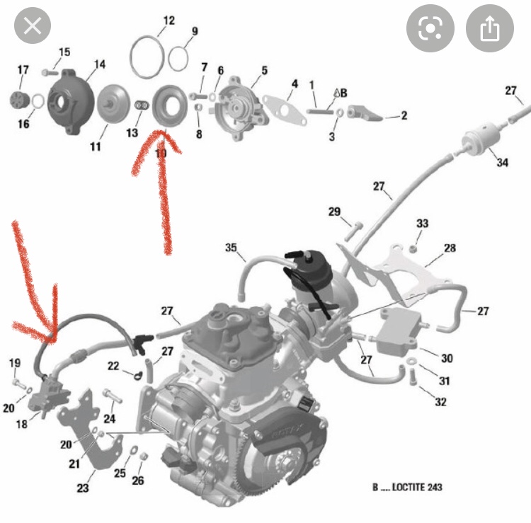

My evo is a gen 1(2015/2016) and the power valve cables to the case/solenoid/pump are ran different and the spring in the power valve is below the bellow and not above. I came across an article about changing the cabling to the new gen but nothing was said about the PV assembly so the cabling was changed by my local shop but nothing changed rpm wise. Brought it back to them and he rebuild the PV and it had a spring below like gen 1 and a spring above like gen 2. Once they pulled that out it was over 13,000 right away. My suggestion would be
A) take a picture of the cables between the case/solenoid/pump and I’ll tell you which one it is. If it’s older I suggest changing it.
B)disassemble the PV…good video from power republic how to do this on YouTube. Check if the spring is between the bellow(green rubber) and black cover or if it’s between the metal body and bellow. If you have both, change the cables and remove the one between the metal and bellow and your good to go. Just make sure the PV blade is moving freely too. Throw some oil on the blade.

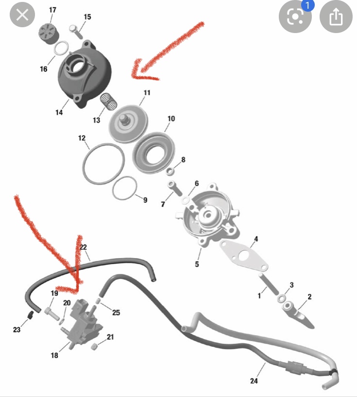

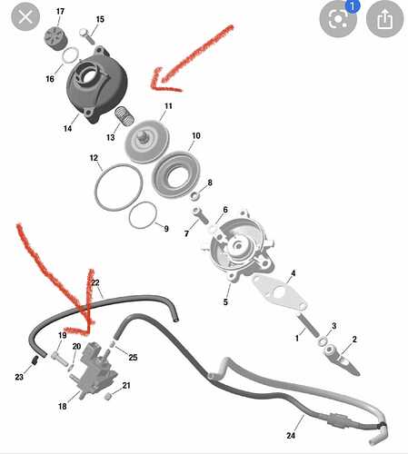

Was able to find pictures of the 2.
You can see how one has a spring below the bellow and the other is above.
The new gen is above and was told this works much better than below.
Also you can see the pipe runs into the solenoid in the pull position on the top of the solenoid. The other runs in the push position so the green regulator arrow goes in the other direction.
The springs are different. The one below is small about 10mm and the one above that you want has a 20/25mm spring that’s black with a line of green spray paint

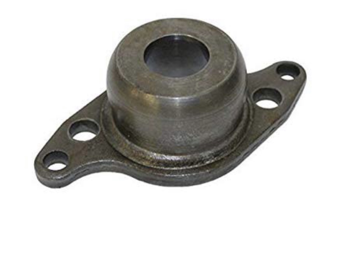

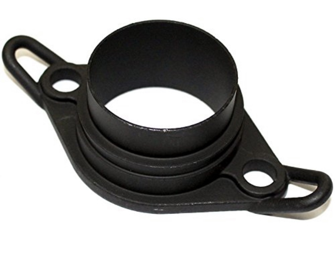

If you have a restrictor the exhaust flange will look like the first pic. If not it will look like the 2nd pic.
