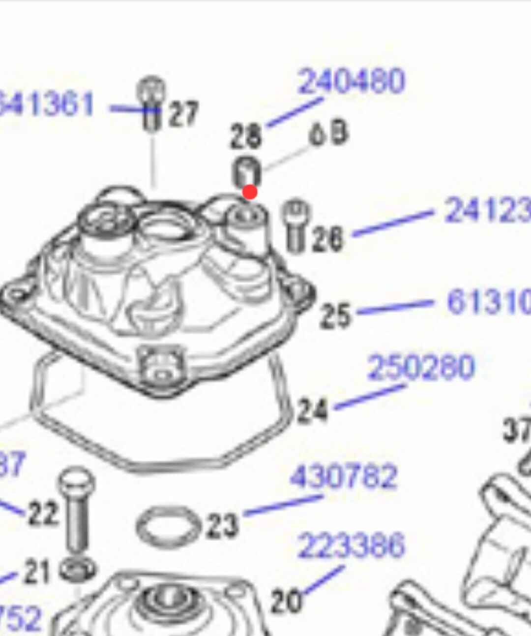

And where is the hole to put a temperature sensor please?
Sensor is in the cylinder head.
So I put it there? Red point
Thanks! I did it and it’s no1
