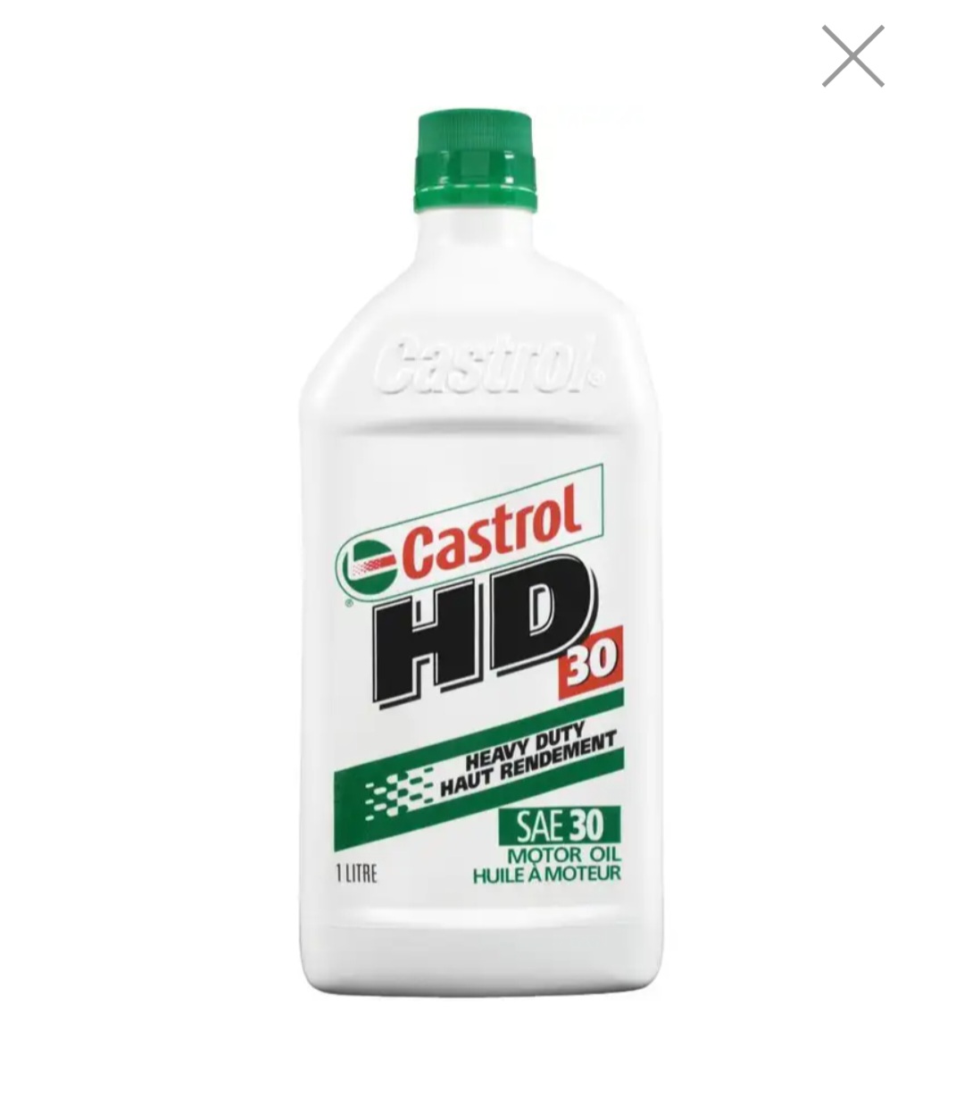

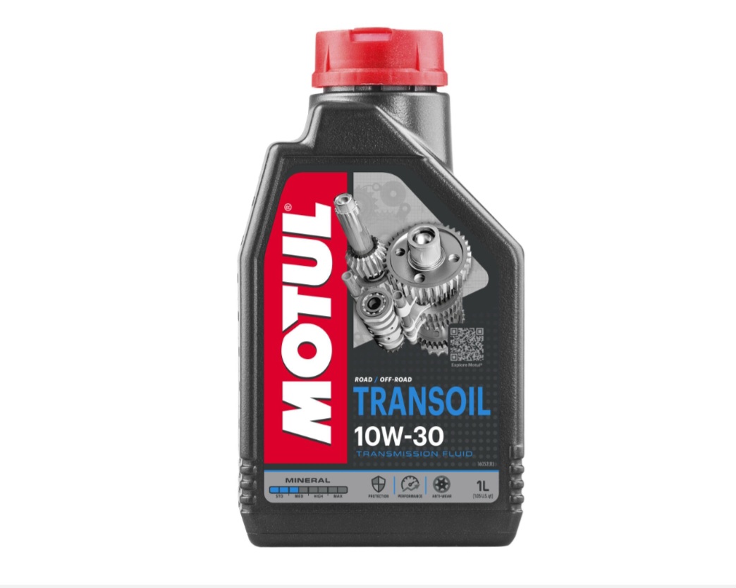

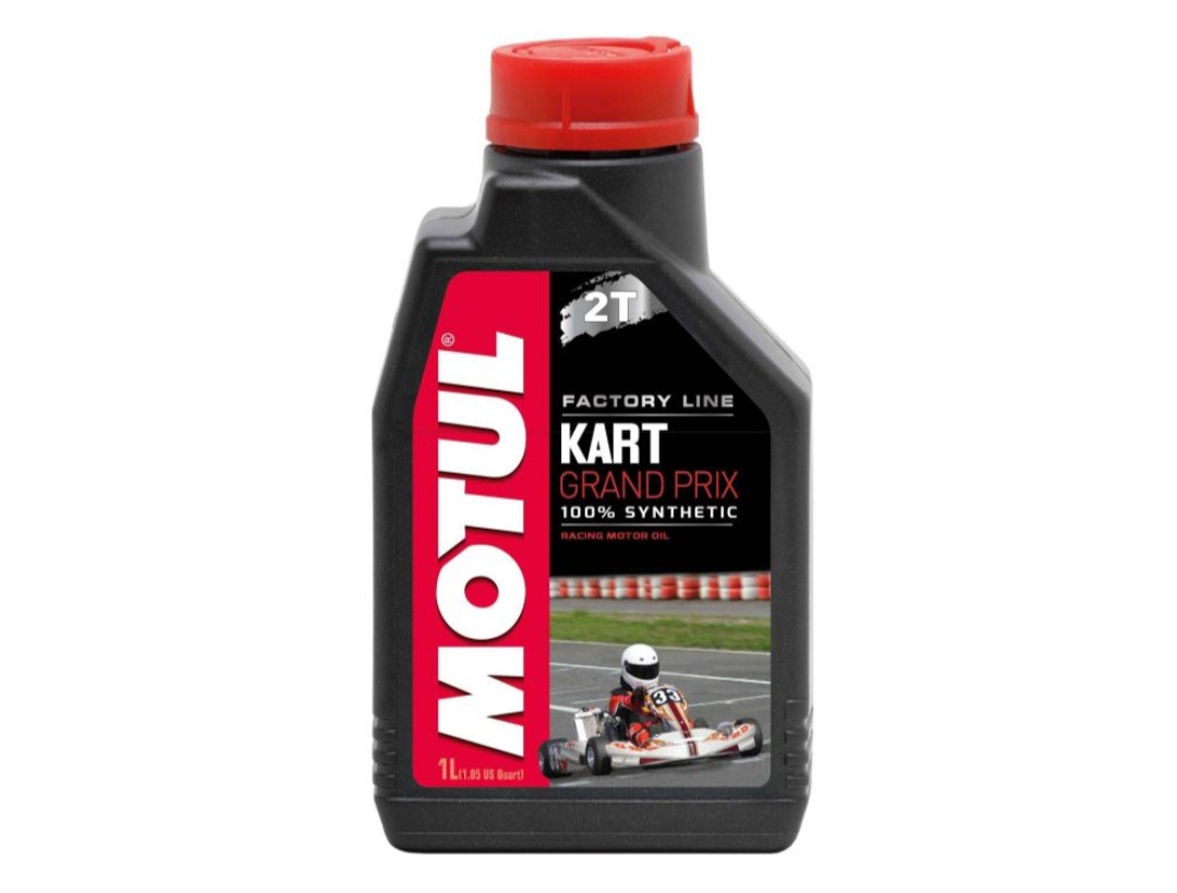

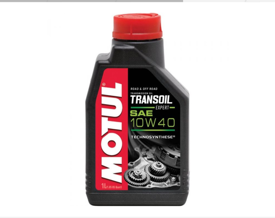

Hello, I would like to know which oil I should put in my gear, between the three, Sae 30 - 50cc, suggested on the engine, and if the motul grandprix is a good choice, 50:1, for my mix of gasoline with premium. I don’t race, just to ride on the track. I am in Quebec, Canada ! Thank’s
We are using the Motul Kart Grandprix, except for the races offcause.
We run 40:1.
Gear oil you Can use any of the ones you have pictured, we use around 60-70ml and change it every 3-4 hours
thank you very much!!! it helps me a lot
