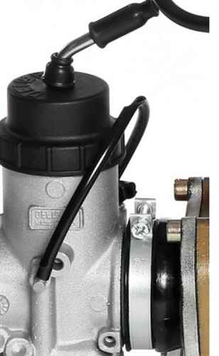

you need to have a small cut on the green hose that goes from the one side to the other side from the upper of your carb … from breather hole to hole . do you have the cut ?
also those 2 exits has to be cleaned

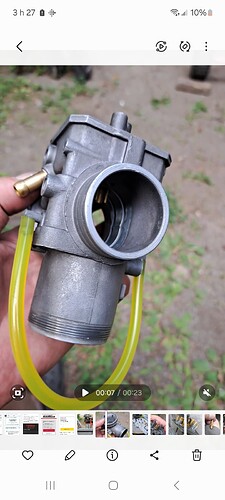

Ha! well, no I don’t have a cut. This pipe was broken when I bought it and I put a new one in thinking it was ok!. I don’t really understand how I do that. Here is a picture I took when I cleaned the carburetor. It shows how the pipe is right now. Thanks!
As these are two examples: and can it really make a difference?
yes it can . had some problems in the past with those
Yes the carb needs to “vent” and equalize with atmospheric pressure to work. You need to add a similar cut to your green tube.
That could verywell be the issue, it will have a hard time working without the Cut In that line.

To summarize: Snip a small break in the breather hose and verify your jetting against your oil ratio and whether you have an evo or “prevo” engine. The new ‘24 cylinder may also be a factor but I’ll leave it to people with more direct experience on that to chime in.
