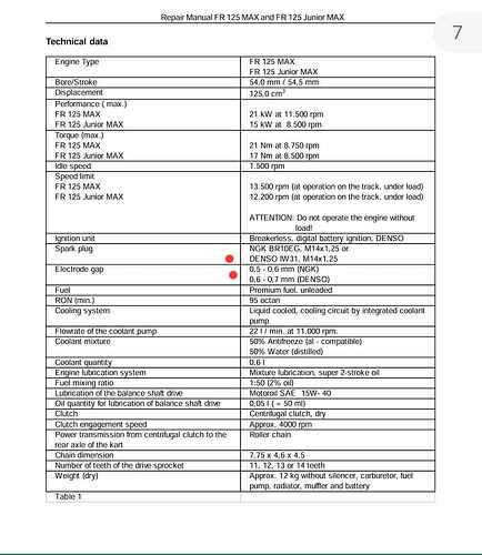

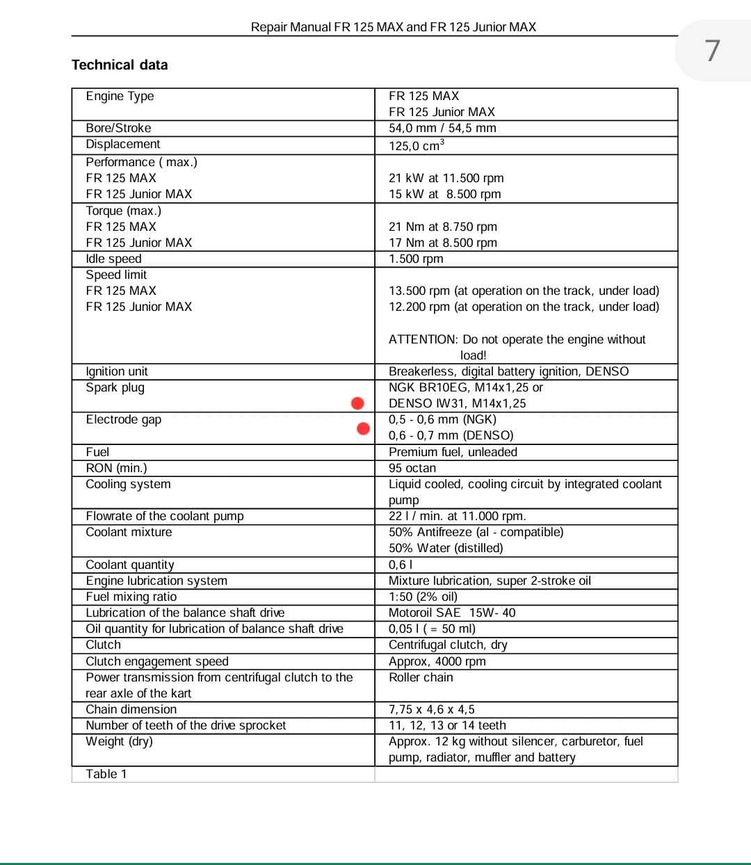

Yes Clayton, they look new, but the engine tries to start, it starts a little, but doesn’t really want to start. And when it happens while driving, it just won’t start anymore. The second I put a new one in, it starts again, everything is normal, and my rotax works great. These are the NGK racing plugs, recommended by rotax, the one that replaces the Denso iw31.
They all come with the correct gap and I check, 0.6 mm, so according to the recommendations, I leave them like that. You tell me if I’m better off putting them at 1.0 mm. Soon I’ll test them all, I bought a good quality spark plug tester, blue flame ok! red flame no, otherwise no flame at all.
I have a Preevo engine and not an evo. As long as I haven’t put a new spark plug back in, there’s nothing to do, I can’t start again, can’t start anymore, only intermittently. They are still spark plugs at around $9 US, cheaper than Denso, but they are starting to cost a lot for spark plugs and I would especially like to find the problem with that. Thanks
