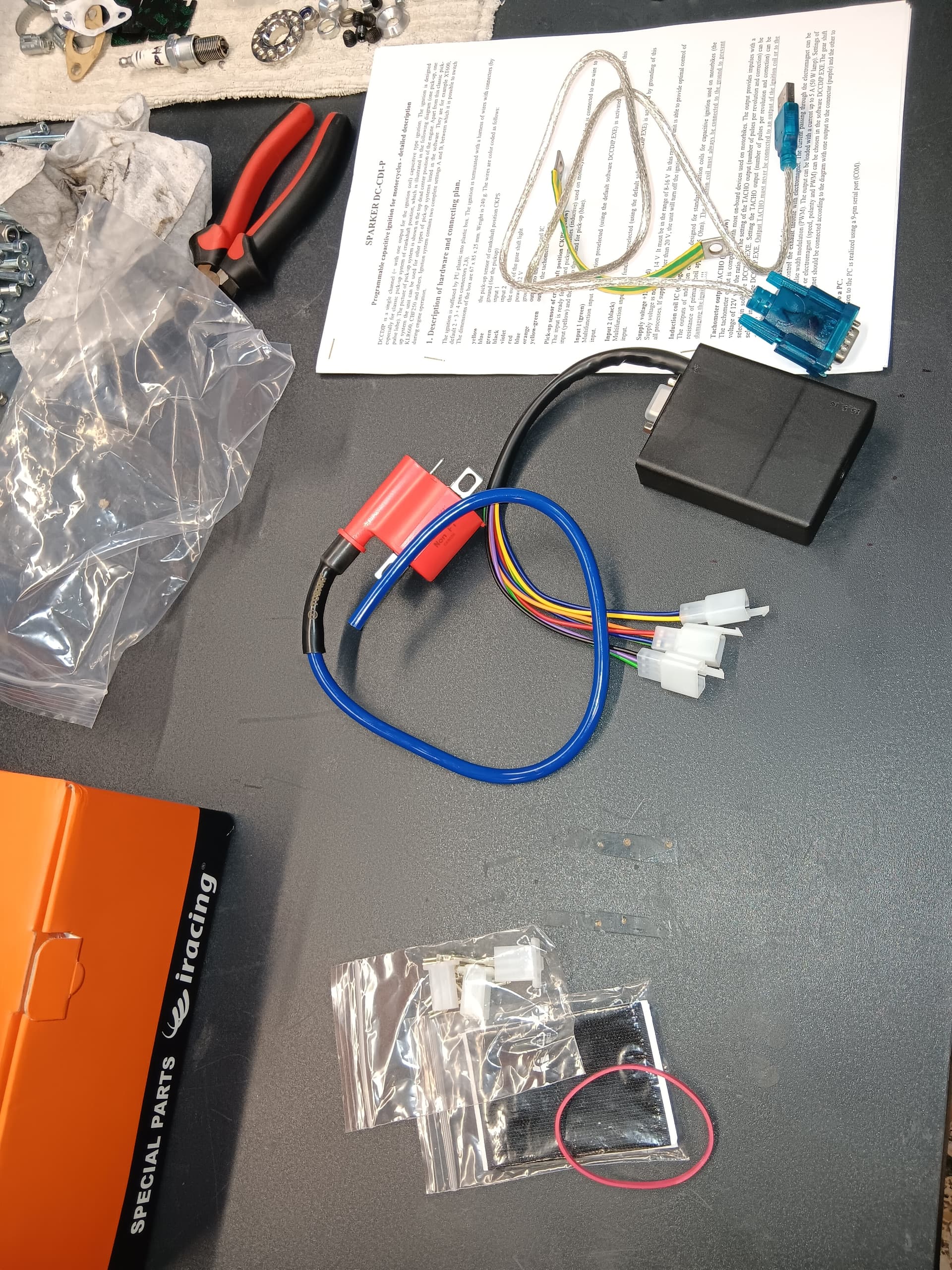

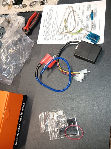

We have used the Ignitech V 109 adjustable ignition system that comes with its software cables and stuff .

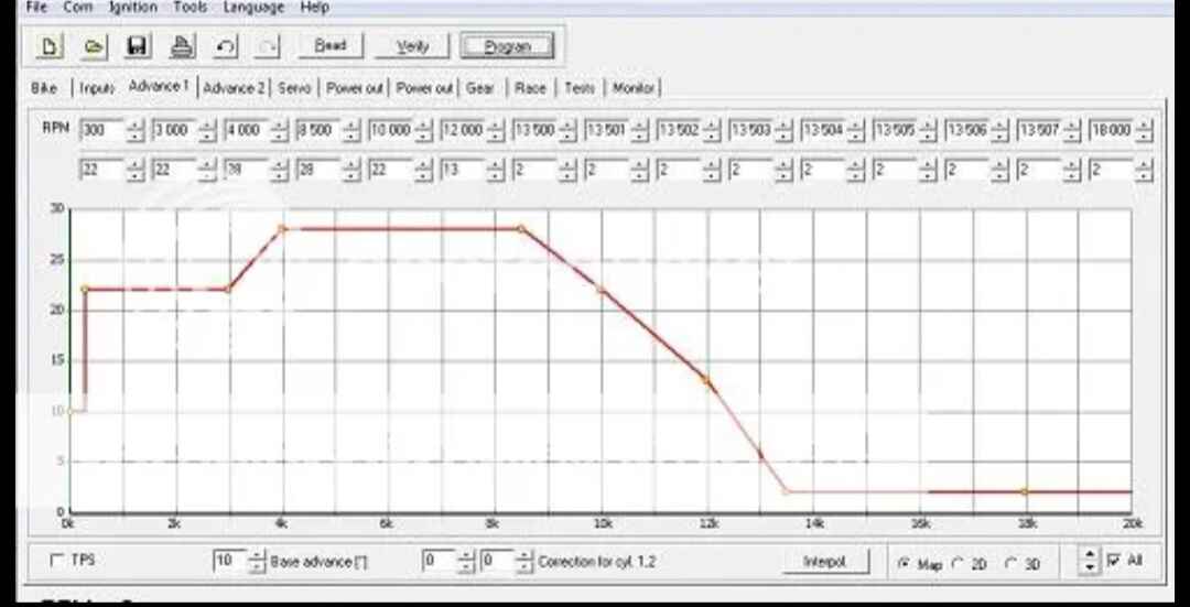

NICK is our 2 stroke expert here and he choose to be somekind of gendle when it comes to tickle with the timing advance after baseline set up , coz if you are crazy enough you could create a big hole in your pistons head really quick!
But yes even with the standart ignition map in the program the engine was much more lively ! And the costs are worth it .
Give me a second to find the default ignition map .
That was a tricky task when we search weeks before that question of yours …
Here you are mate . Good morning
That’s awesome, thankyou so much.

no dramas from the reading of the standard pick up sensor read from the program . we use the stock one . Nick had use Tobaki racing ignition coil . the red one with no problems , but ignitech makes ignition coil sets you can buy and use with this set up also
