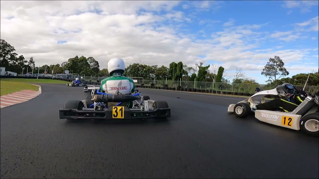

The track has both tight and open sections so is hard to drive/setup. Video attached. These 2 guys have been racing open for a while but still felt at a disadvantage.
Was 1 second off on a 48 second lap. My best was 48.8, one guy did a 47.8 other guy did a 48.4.
Also first time on a grippier tyre. Gone from Dunlop DFM to Lecont SVB which caused a world of hurt being over gripped. Made a few changes this week which i will hopefully test on the weekend rain permitting.
Its a EVO. Doesnt fell like it bogs ever.
Float is set correctly. We are at sea level around 1020 pressure, 60% humidity, 20-35 degrees through the day here in Australia. Had a 122 main on clip 3. Plug was perfect. Engine guy said i could have been 1 clip to lean on the needle.
Bottom RPM was 6900, top was 13900. Took 2 teeth off rear going from restricted.
Have no other data on rotax at the moment. Will set my go pro up to film my right foot hopefully this weekend.
The Rotax is going to be worse on the bottom and top compared to an X30. Rotax makes all it’s power in the mid-range, and the X30 is a bit more linear.
Looks to me like you’re a little late to the throttle in a lot of those corners. I would try rolling into the throttle a little sooner but more progressively, as stated the Rotax dislikes harsh throttle inputs.
