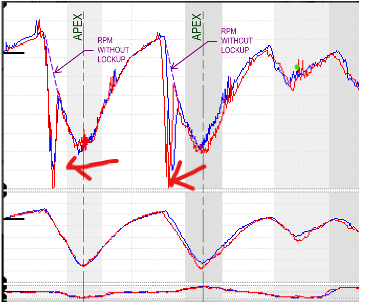

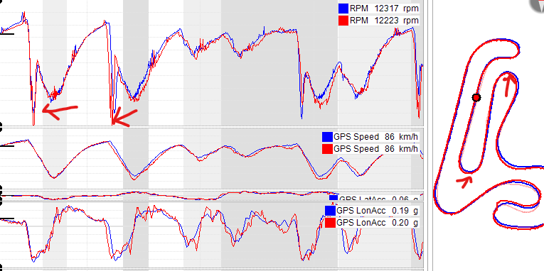

The RPMs are dropping to 2900(red graph) at 2 similar hairpin tighter hairpin i have marked , the graph(blue) isnt dropping which is of another driver … ig their braking pressure is the same for the 1st hairpin or is it different can i have some insights
I would guess you are initially locking the brakes
Yeah, that looks like lockup to me
A lockup near the apex though? Looking at the arrows on the map it’s shows up during a turn.
Or I’m reading it incorrectly.
The arrows on the map are pointed to the apex but comparing the RPM and speed traces the drop appears to be right at the initial brake application. Just looks like locking brakes to me, nothing out of the ordinary.
The dip is immediately after the highest GPS speed in each zone, so it looks like initial braking.
Lockup, as per previous replies. It’s occurring on the way to the apex.
I guess this is a right hand in track then… (Clockwise)
