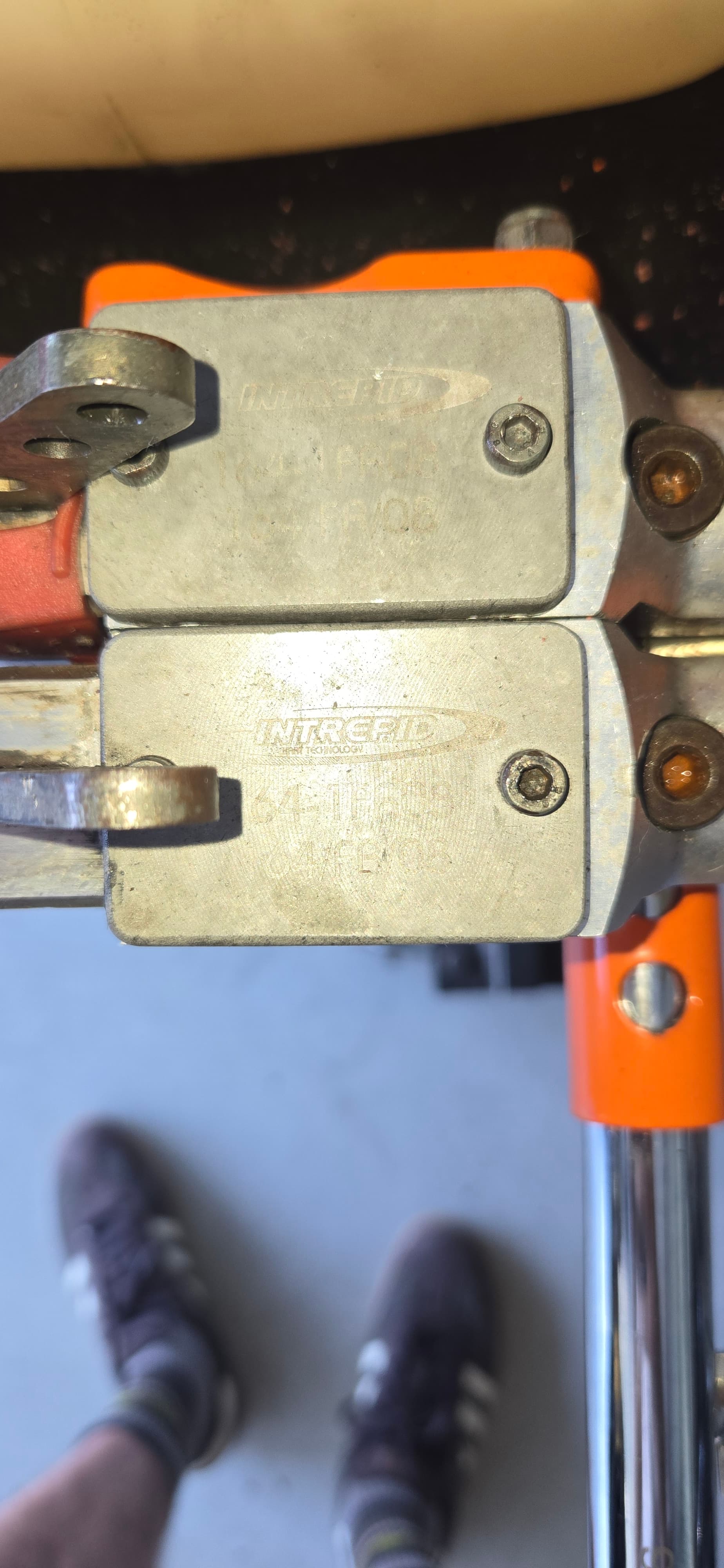

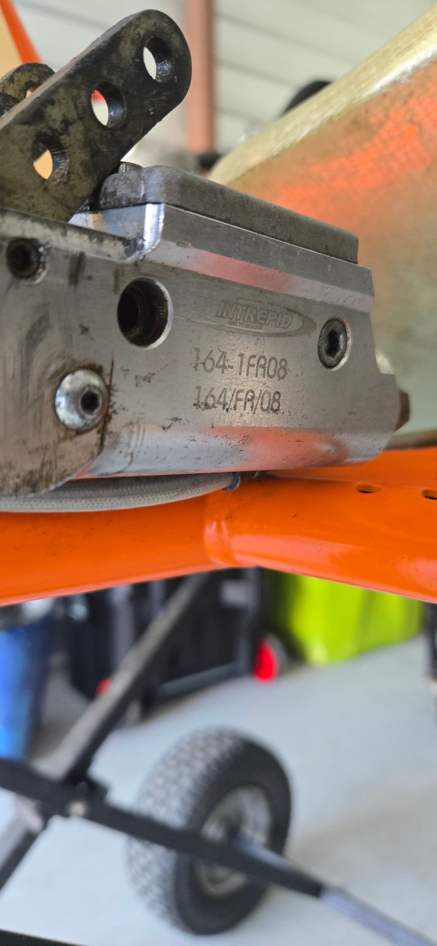

Im waiting om the seals for these brakes which i had to find by comparing if they look the same or not as the originals, and at this point im not sure if i should just get a new set of two (for shifter) IPK, or Righeti ridolfi master cylinders(sorry for butchering) to make future rebuilds easier, the old omes also have some pitting on the inside near where the pumping action happens. Which now that im writing this post im realizing that the new seals probably wont work
If there is pitting you will most likely need a new unit. I don’t know if there is enough meat there to hone it.
Which brand should i buy then if you ?
