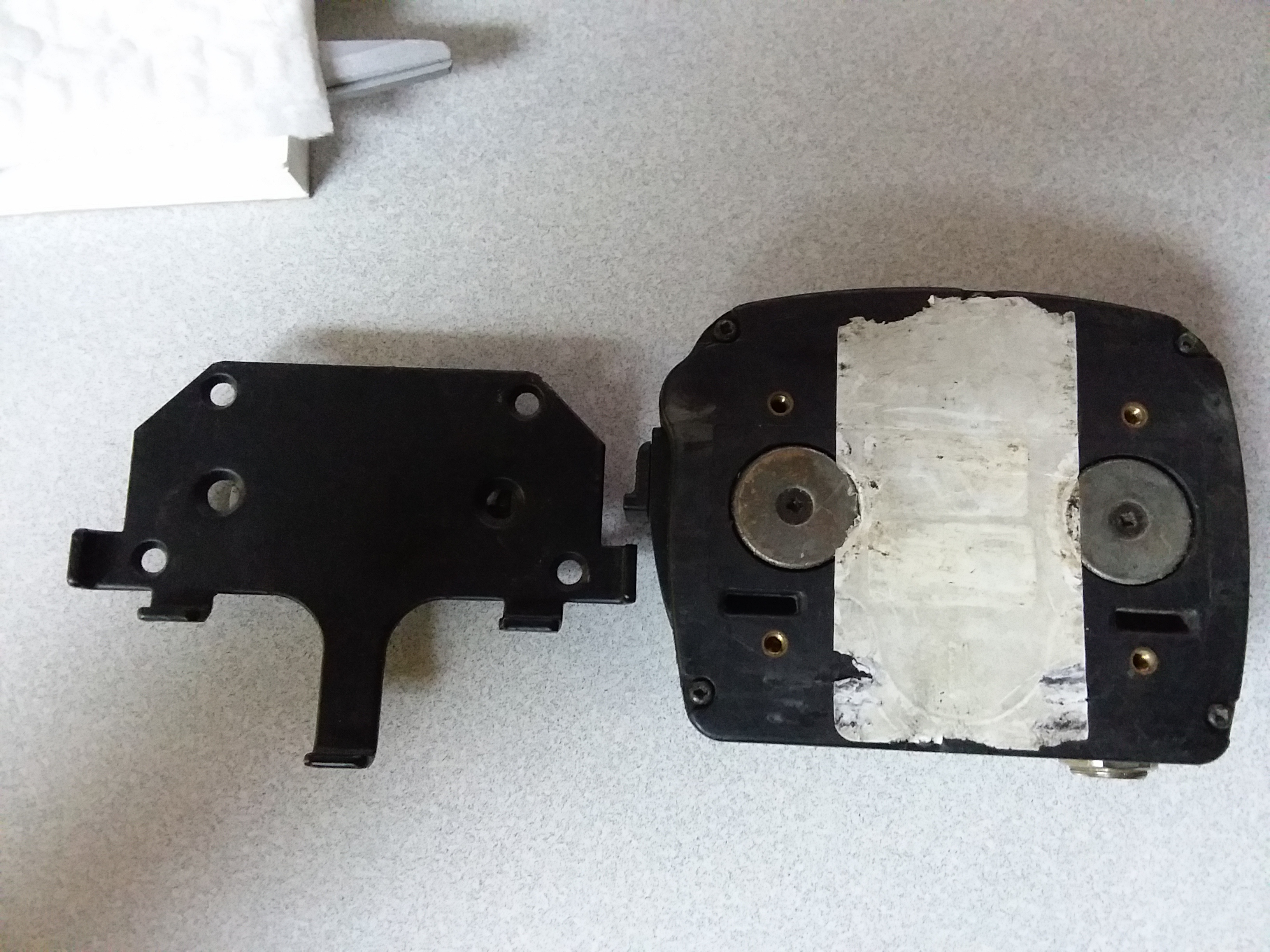

I have a SOLO to try. The mount is steel, has strong magnets and tabs to interface to the SOLO. Someone added a GoPro mount to it, so that might be an option. I’m think adapter between wheel & mount is the only way to go.

20181101_20183920181101_20180320181101_20183620181101_201827
There are also some brass threaded blind holes in the back as well.

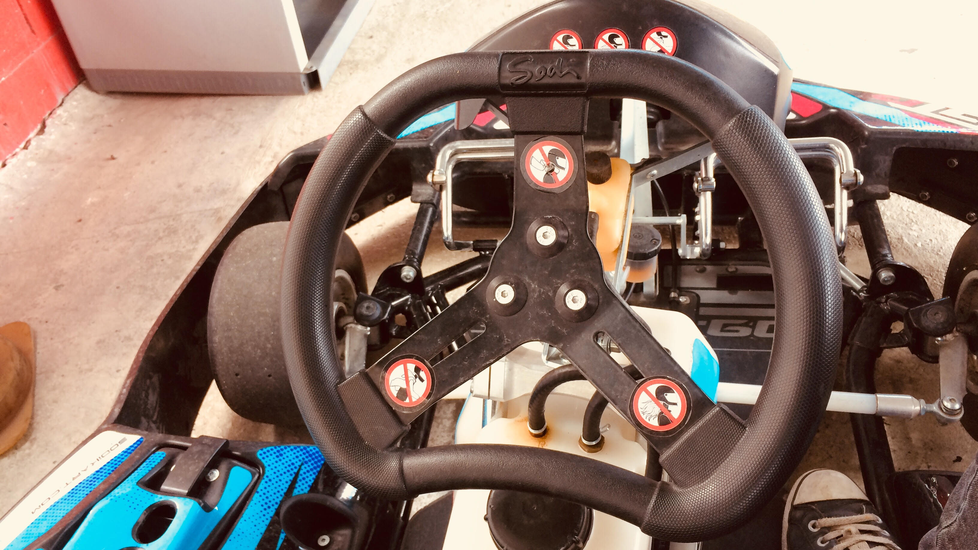

Thanks for posting the pictures. How exactly would this fit into the stock steering wheel of a Sodi GT4R (picture below)?
I don’t have a definitive answer. One reason I started doing rental league was not really having time. So no time to figure it out. TBH also partly because I don’t want to change the complexion in rental league into a spending war either. I could lose 20 pounds and still make weight, karts aren’t real even and some require adaptation in driving style. So I have bigger issues to solve. But your post has me wanting to get going with it & try the SOLO.
I would look at a way to mount the metal piece to something that attaches to the wheel via velcro. The basic issue is nothing will fit between the mount and unit without spacing the magnets out. 2 or 3 diver watch straps, toe straps from bicycyles or velcro cord wraps might do it, if attached to the back of the metal mount. Zip ties might work but I hate wasting things and still there is the thickness.

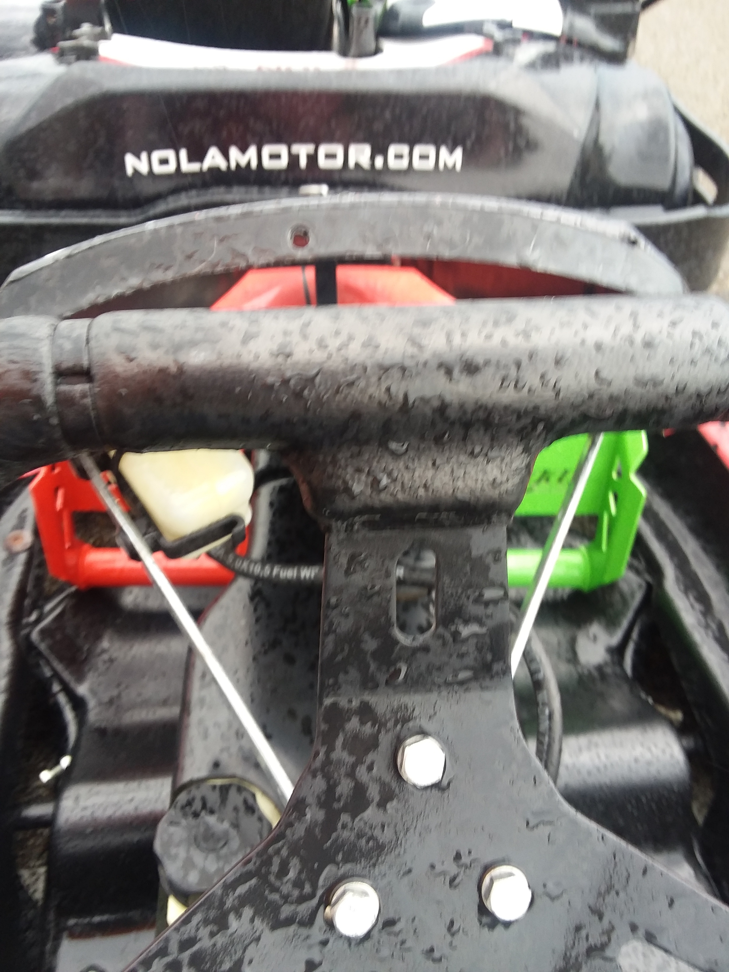

I did get some pics of the mount next to the steering wheel.
20181104_15082120181104_15081620181104_150819
Thanks for the pictures. Doesn’t seem trivial at all to fix that mount to the steering wheel. I’m no longer sure that velcro is a good idea either. Hopefully you can try it out yourself when it’s dry and report back.

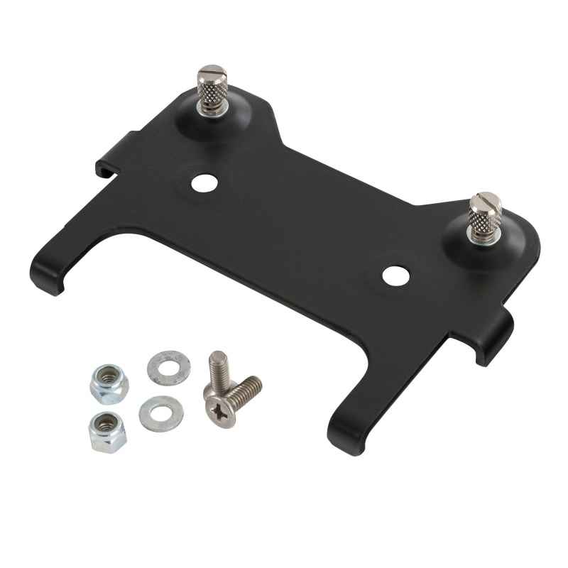

The mounting bracket is below. What holes would you use for the cable tie?
That is why I think an intermediate piece would make the most sense. That way you can optimize the fit to the wheel and then to the bracket.
Even a slight gap of about .045" - 1 mm between solo and bracket reduces the magnetic force a decent amount in my opinion. Not a big deal in a car. I’d say it is borderline in a kart.
