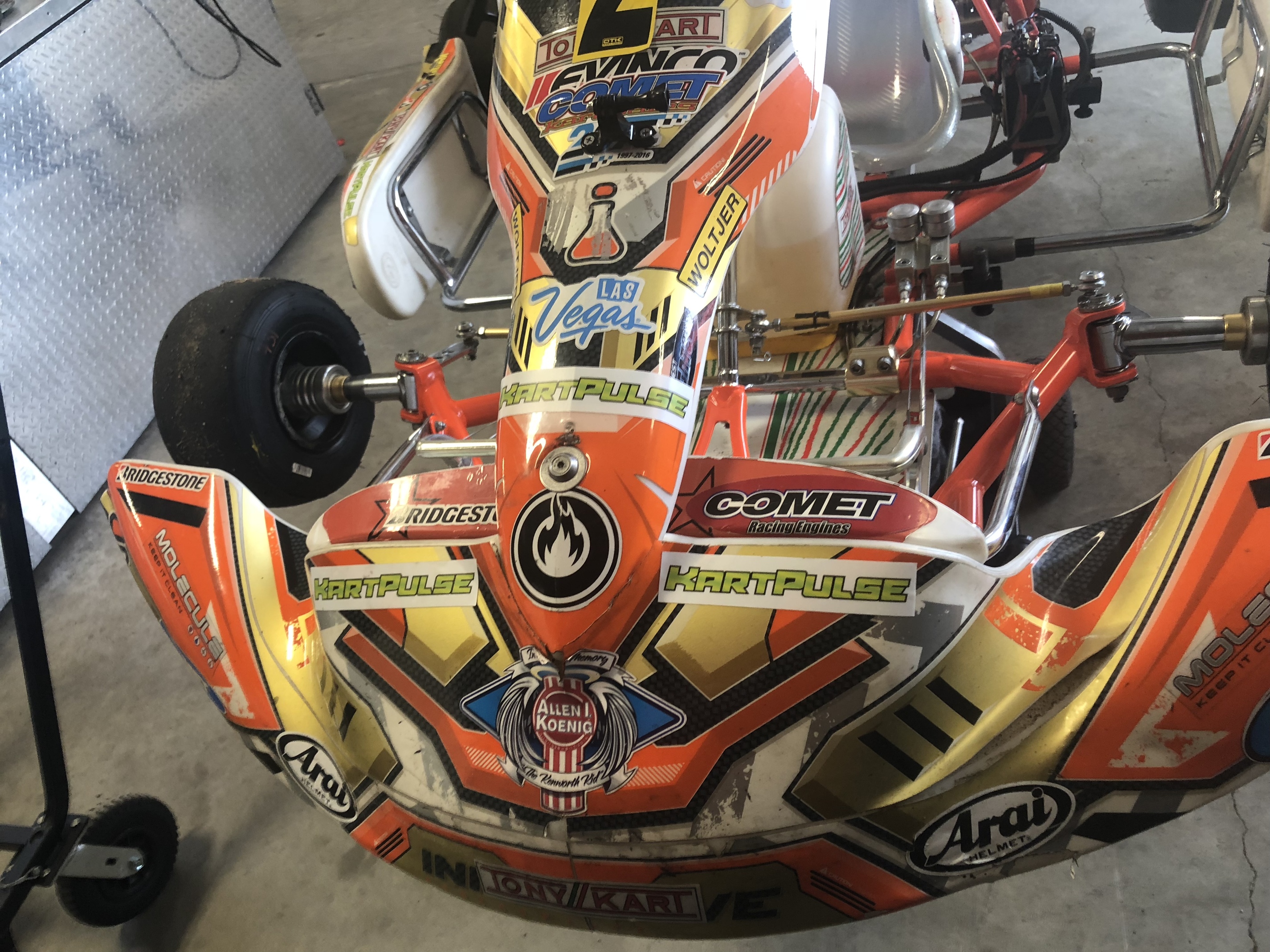

Also, is this your kart?
@KartingIsLife yes sir! The tonykart next to it is mine too.
