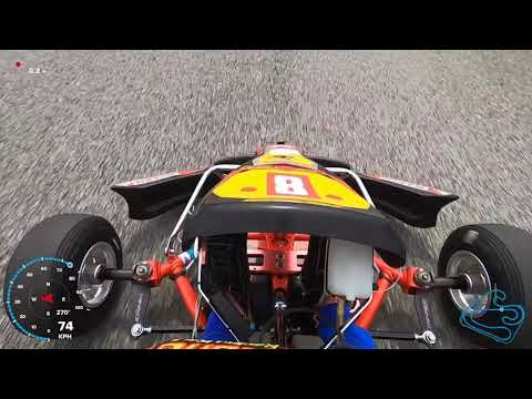

This is him going around on a slightly shorter track layout.
He is smooth and looks like he’s doing well.

Thank you everyone for your help and advices. Race organizer set up the rule which required everyone in this class to go with 12-tooth front sprocket. (We have been practicing on 14T which is the international standard for this class) We tried all sprockets ranging from 59 to 66 and found the one that gave him the best lap times. My son ended up qualifying 4th for each round. Amateur dad couldn’t find the right setup for the cold (and sometimes wet) conditions. Anyway we tried our best. Next race we will improve more. Here is one of his qualifying laps at Orlando Kart Center…
Looking really good. I like how his kart is calm and he appears to be thoughtful about not overdoing it.
Very smooth.
I have only been to OKC a couple times but it occurs to me that if he were to tighten a couple of those apexes, there might be a podium in his future quali efforts.
It might be that those are apexes that you take a bit wide, as I don’t have great track knowledge.
Thank you, @Bimodal_Rocket . I will let him read your comment. I don’t know anything about driving a race kart (I’m pretty good with a mini van tho hahaha). I’m just trying to do my best to support his passion.
