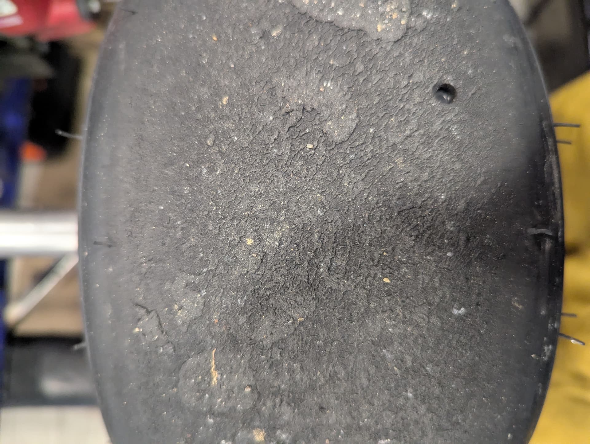

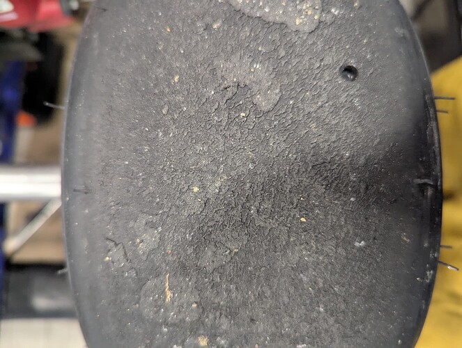

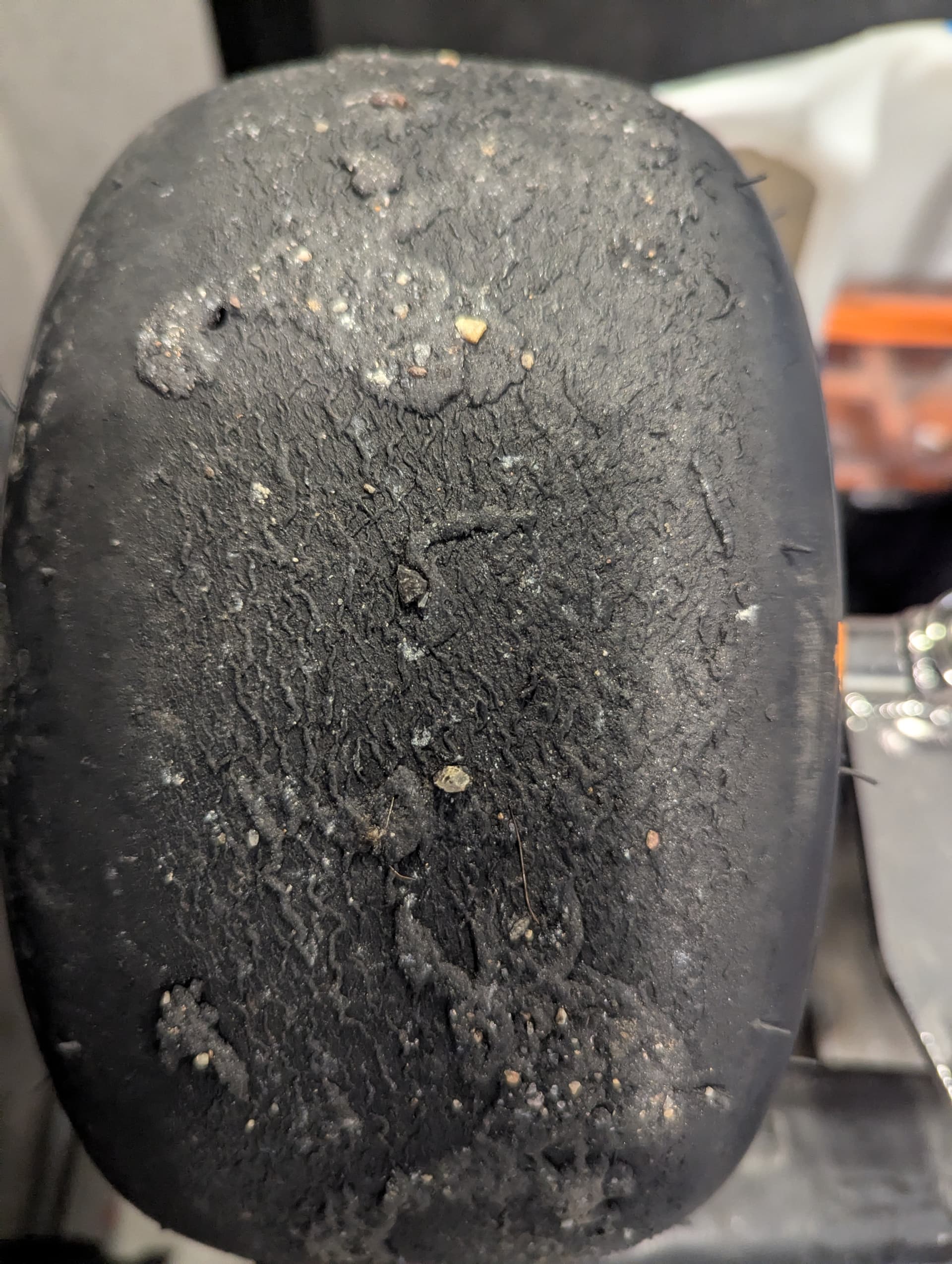

Kid kart +7 seconds per lap (~1:45/lap) after adding about 7lbs (3.2 KG) to the back of the seat. It was a hot day today 28c/82f. He is only just turned 5 so anything he says about the karts handling is unreliable. Tire pressure is about 19psi all tires. Cant got past 20psi per the rules.
What I do know is that the kart is much slower. The front tires picked up quite a bit of rubber but the rear tires are clean. This makes me think the extra weight is causing the chassis to flex just enough that the rear is dragging the inside tire.
Does my hypothesis sound correct?
