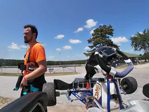

2:10 race 1: this is a good example of vision probably being a bit too focused on what’s directly ahead, which is normal considering it’s first race. That’s a lot of karts and visually quite intimidating.
Look through the guy ahead, not at them. Try to make sure you are taking in the big picture. Move your sight around and greedily take in as much detail about the big picture as you can.
The mind stores the info you give it. The kart directly in front of you does have to be glanced at repeatedly to place it in space/time but in general your mind will deal with it peripherally, vision wise. Trust that you will see it without looking at it directly, look through and ahead.
Anyways, that’s how you avoid wrecks ahead, by seeing them evolve, which you can’t do if you are focused on the here and now as opposed to also having an awareness of the track two or three seconds down the road.
