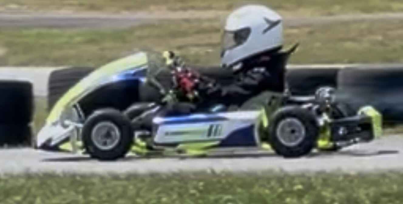

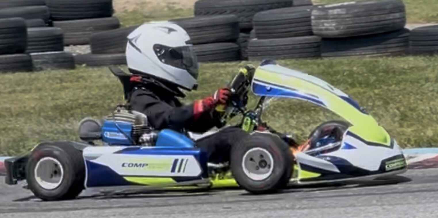

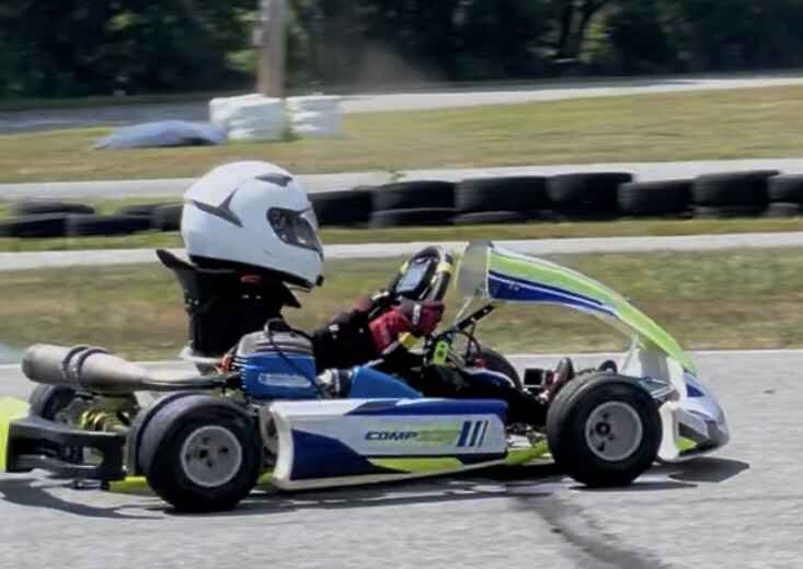

Can you post a photo of him in the kart? Only way I see getting a bruise there is sitting a bit hunched over with his back rounded. Or the bottom of the rib protector rests right there?
I think lots of people get bruises there but there are lots of padding options.
They range from putting some roam or raggs and taping them in place to foam with adhesive backing which you can cut to the shape you need and stick to the seat.
Is the seat too big for him? Ideally you want to be pretty much wedged in there.
Any protruding hardware? I get random bruises in rentals a lot. Seat size is perhaps too large?
I think both.
He tends to be hunched over at times.
The rib protector does end pretty much where the bruise is.
I did the best I could cropping the photos from a video.
It’s hard to tell though.

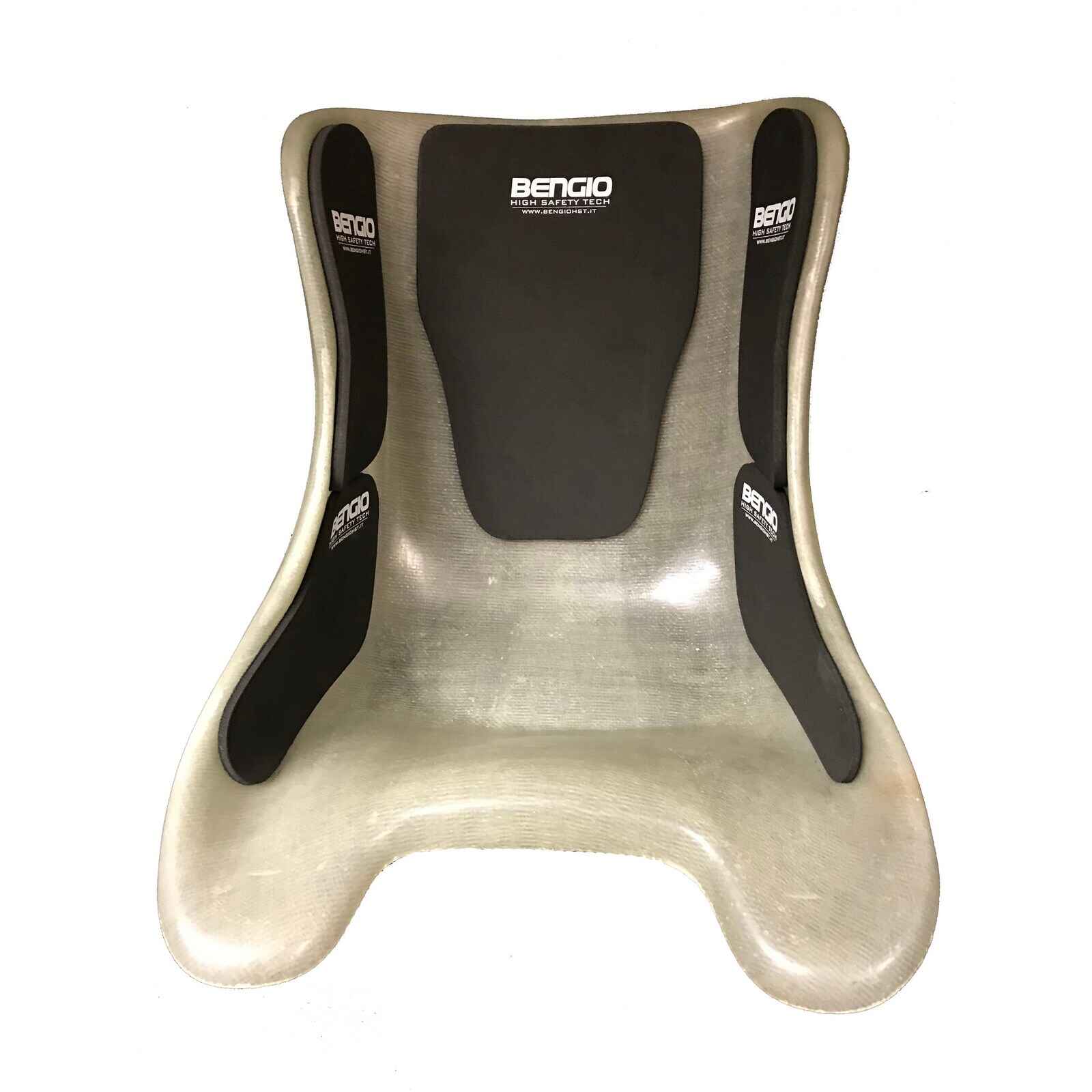

Nothing there. Brand new Tillett seat. Tight fit. I reached out directly to Tillett about fitment and they advised to get this size:
The seat originally mounted in this kart was huge compared to this one. I had to pad it heavily before.
This one has no padding.
He’s wedged in.
I made padding for the old seat from sheets of XLPe foam or EVA don’t remember which type exactly.
I might have some left.
I’ll make a pad for the back of the seat.
I just wonder if where is anything out in the market that people used for spines :grimacing:
There are padding kits. I’ve also used neoprene adhesive backed squares from Amazon. @tjkoyen uses a medical gel pack.
You can use a piece of bicycle handlebar tape to cover the central rib of the back of the seat.
