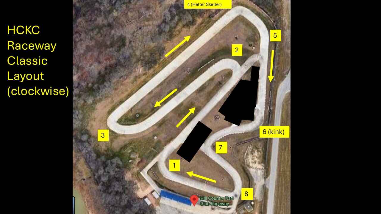

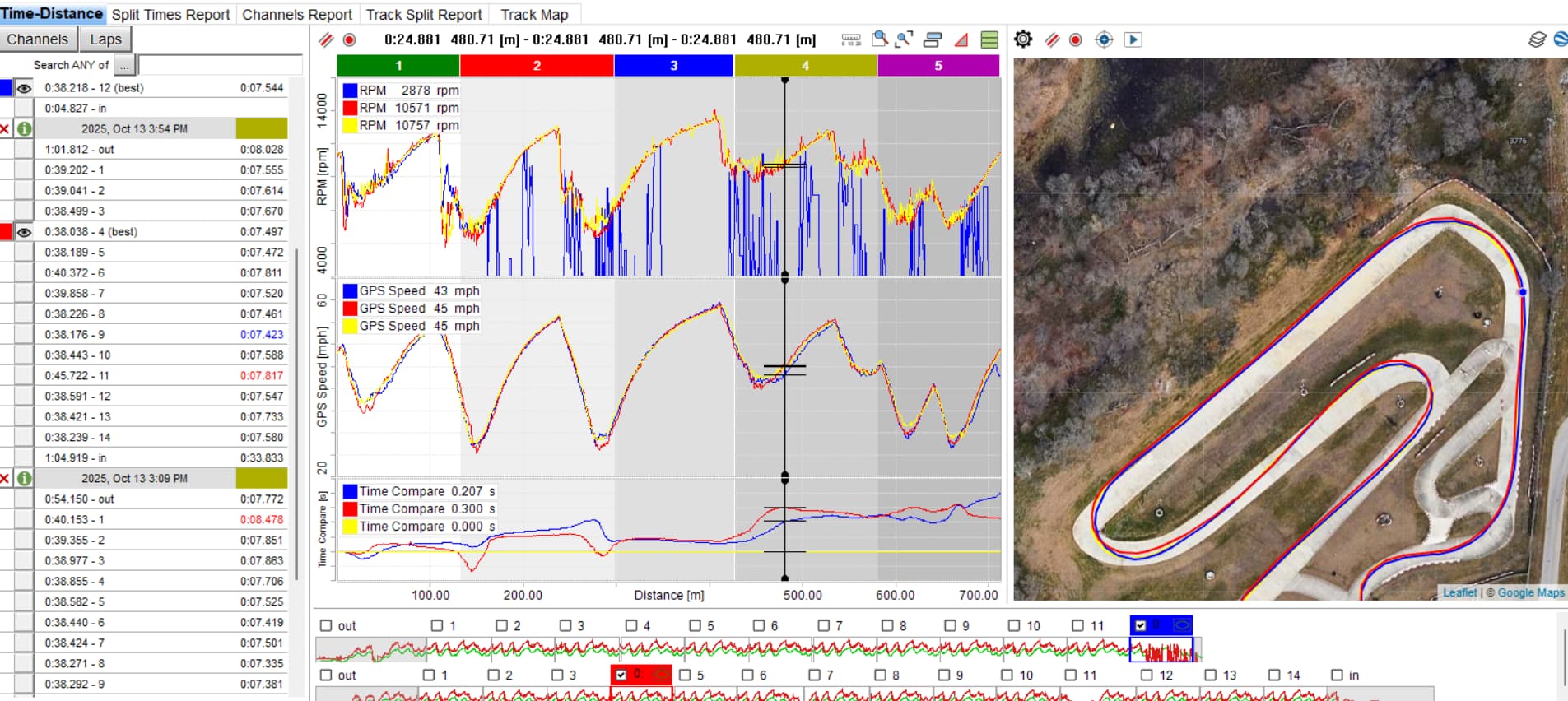

Data analysis: Yellow is a 37.8 on used Levantos, Red is a 38.0 on used Evinco Blues, Blue is a 38.2 on new Evinco Blues, and I don’t have data from Tommy’s reference lap but he was doing mid 37s that day. Red and blue laps lost time coming out of the slow turn 2 and lost even more time through the fastest corner on the track, which is a very bumpy right-hand uphill sweeper that we call Helter Skelter (turn 4, 0:26 in the video). I couldn’t find a good track map online, so I made one. I really need to get data from Tommy. Sorry I don’t have good data to compare mine to:
