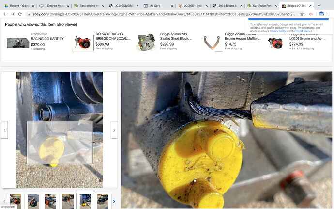

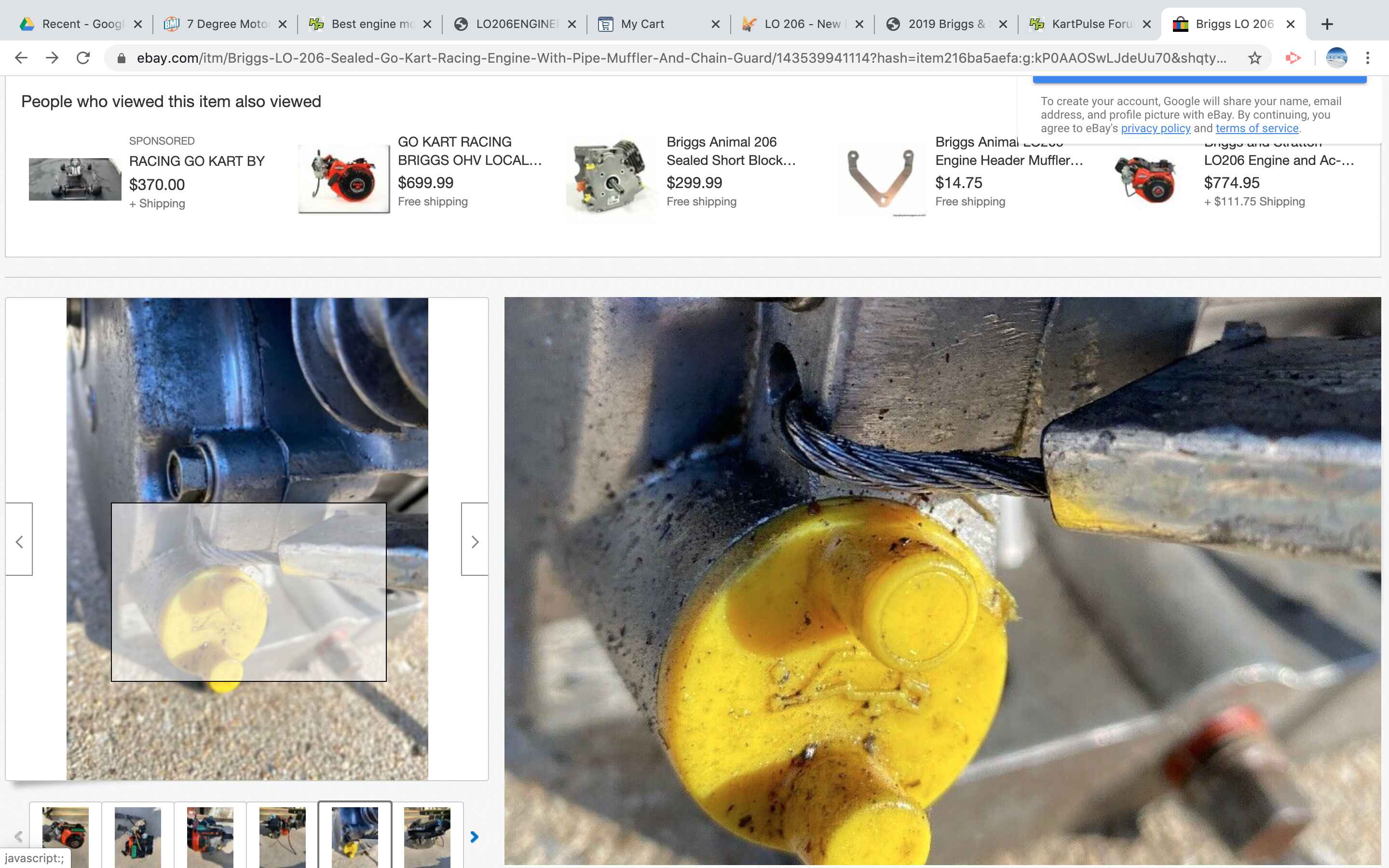

Is running in LO206 class make sure the seal is new enough to still be allowed. I do not see the black line in the seal wire. It has to have one to be legal.
The seal must either have a black wire intertwined or be the newer orange seal type. If you look closely on this one, the black wire is just visible on right side, so you are good there.

Look closely. It has the black tracer wire on the seal.
Thanks. I looked again and sure enough you’re right. Updated my previous post.
Thanks for catching it.
