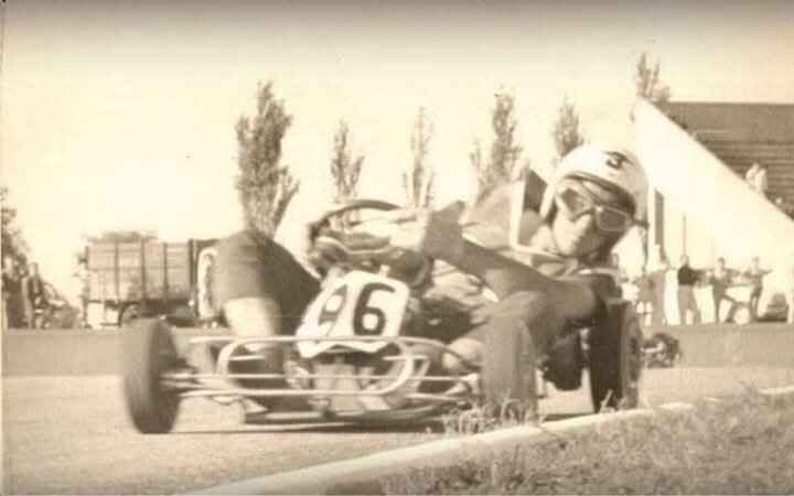

I’ll post unique chassis from the 70’s as I run across them. Seems like RD350s/400s were the early engine of choice. From Argentina:
I had to include this image of a total bad@ss:
Watch out for that shoulder rub, guy!
Kinda reminiscent of the guys in in Moto GP with their knees so low they have plastic kneecaps rubbing the ground in their turns.
